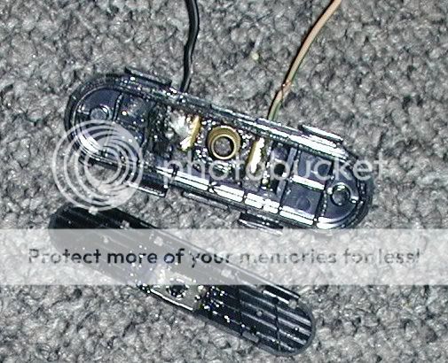

As for the hatch release. With the 2005 magnum factory cluster I added a trunk release button to the empty plug, prewired in the factory harness. (hanging directly below the parking brake release, behind the knee rest.) that worked fine. With the 2007 Cluster I simply removed the 4.7k ohm resistor, and plugged the wires back together as they were before the mod. Now that functions fine. In the hatch handle is a 4.7k Ohm 1/4 1/2 resistor. Remove the handle carefully cut into the left side of the handle, and remove, or bridge the resistor. Fixed. (Thank 65Standard for his outstanding research, and development.)

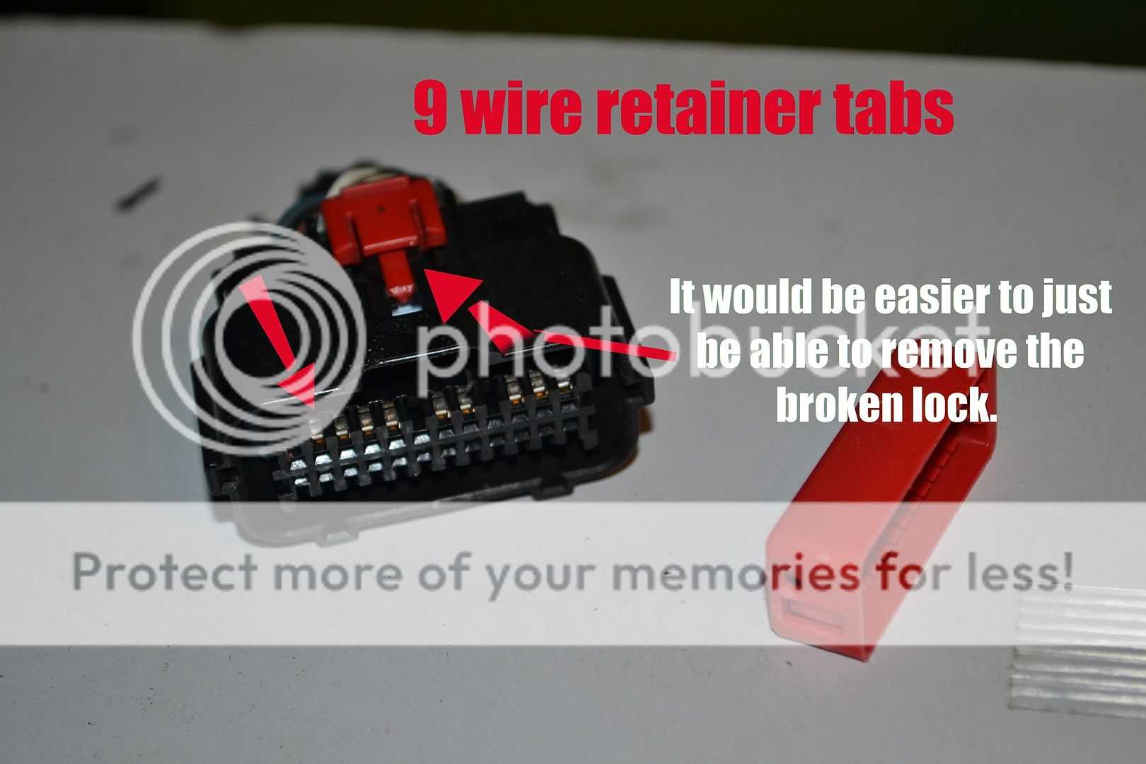

If you didn't know.You can remove wire from the weather connectors, and replace them in a new plug.??? : What I'm not aware of is if/how you can just replace the red locking tab, to make things less frustrating, an quicker. Wire bunles age, and they get tough to manipulate.
