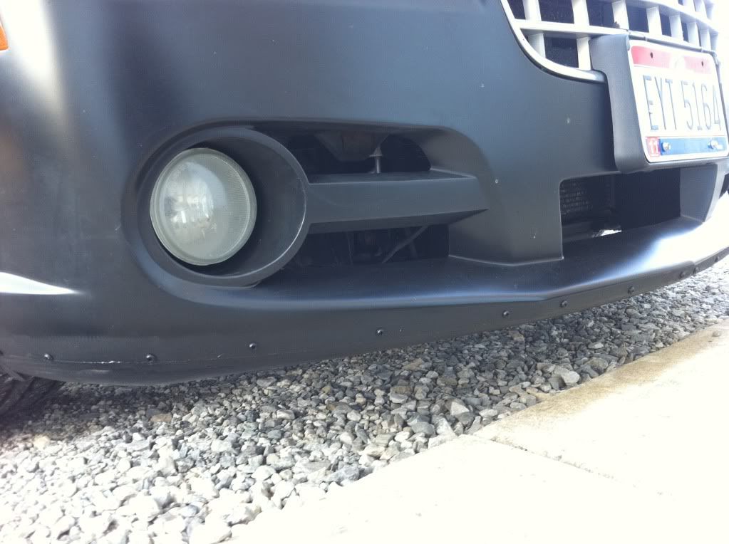

I did this to my Grip bumper on my SRT.
Get rid of the screws and flush mount it using countersunk rivets.
Then use a filler specifically designed for flexible automotive parts like Lord's Urethane Filler Adhesive.

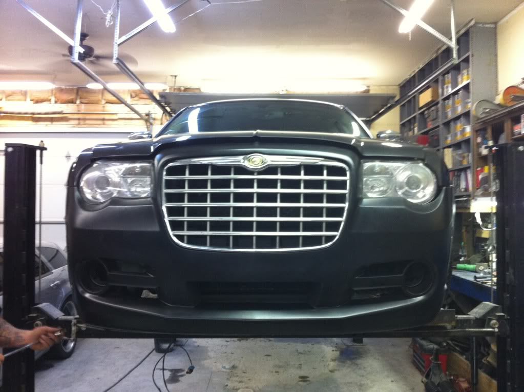

The results look very sharp!

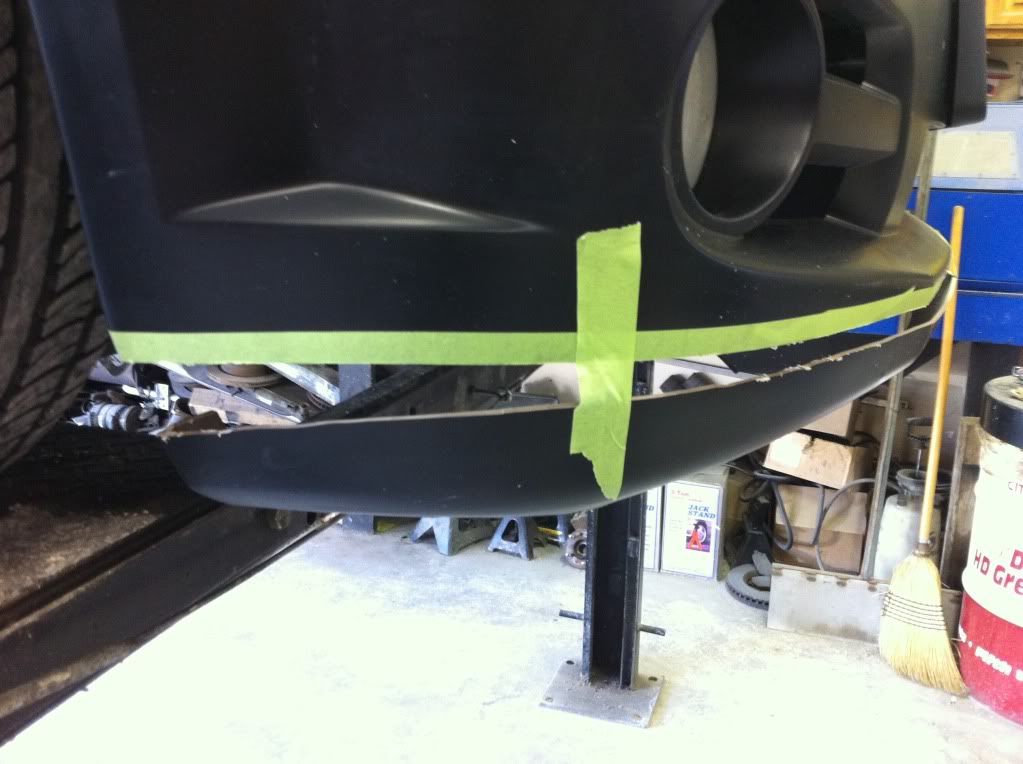

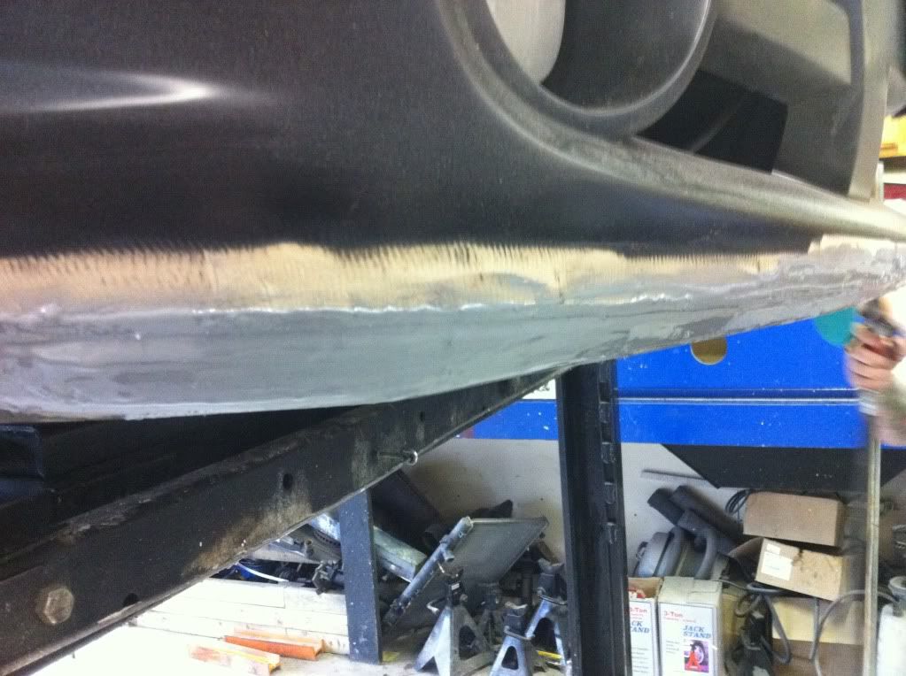

Thanks fellas. It's no where being close to finished. The 3M adhesive takes awhile to cure before the next step. I'll have more pics.

Here's mine right out of the box. I cut mine because in the winter with stock 20" wheels I'd really set low up front. Now I can adjust the front coilovers to have a tight wheel gap.
