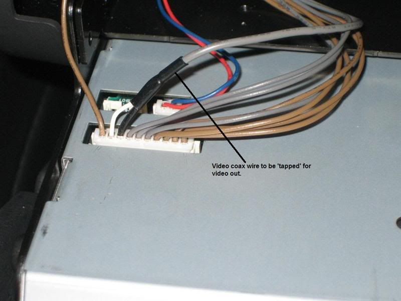

while I was at it i installed the rca out so i a see the video on the mygig
very nice
The wiring layout I posted was for the original VES to REC 10 pin connector. I overlooked the fact that you are using the MyGig unit. The 10 pin on the MyGig is only for the microphone and iPod interfaces. You should take pins 4, 7 & 8 (from the REC 10 pin) and route them into the LockPick AV harness. Is that what you did? You'll then need to go to the VES setup screen in the MyGig unit and select the power on option to enable the input.
