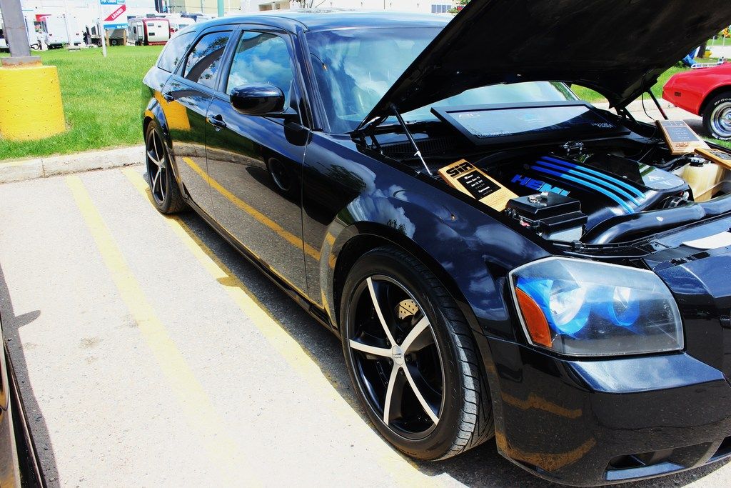

Not the best pic, but here's my AWD on BC Racing Coilovers
Rear camber went to 3 degrees, front to 1.5 degrees. Got the rear corrected to 1.5 degrees with bushings.
No idea, didn't measure. I just know that I started at AWD height and I believe I'm a little lower than SRT. Any lower and I have to worry about bottoming out.
