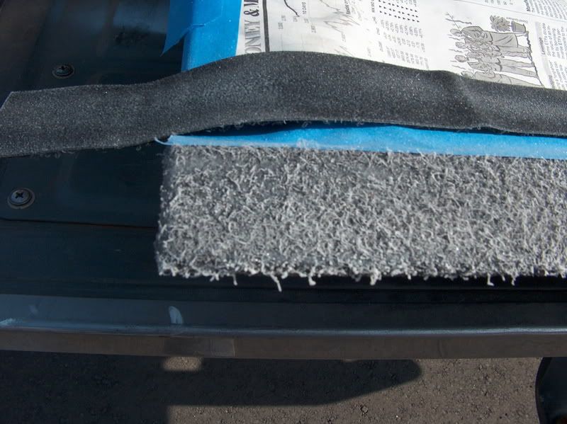

I used 2" Industrial grade stickyback velcro but applied it with 3M #77 spray adhesive rather than rely on the stickyback.
The Velcro was cut 2" per side longer to wrap around and adhear to the bottom side.
I masked off and the application area and also used newspaper to eep the spray adhesive from getting where I did not want it.
I applied a heavy coat to both the flocked area of the pan and the back side of the Velcro. Also sprayed unser the area to grab the extra 2' of Velcro that wraps around the edge, This really stops that edge from peeling.
I got really coverage and pretty much soaked the flocking for good adhesion.
Time for a break to let dry for 30 minutes, this stuff works best when very tacky.
