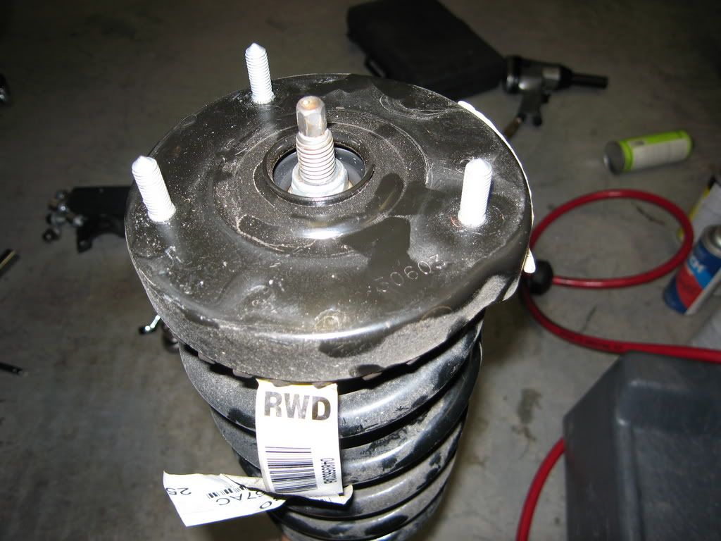

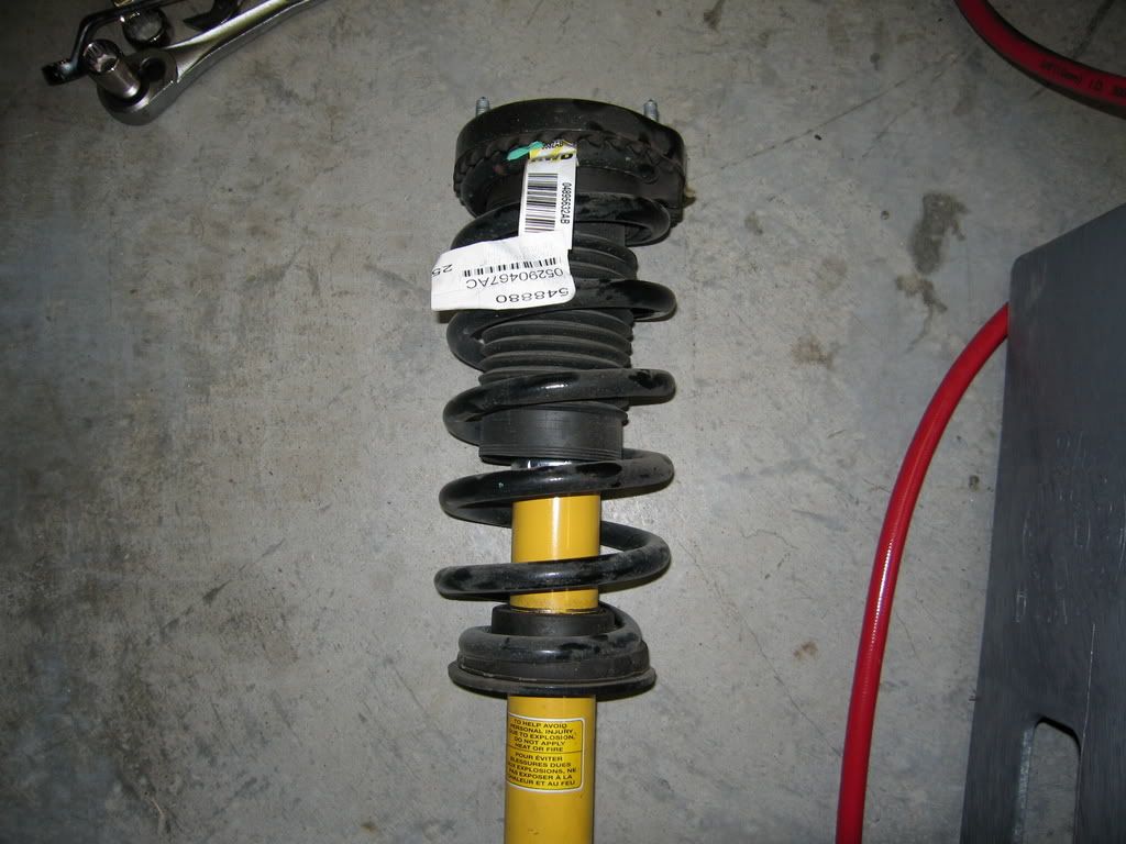

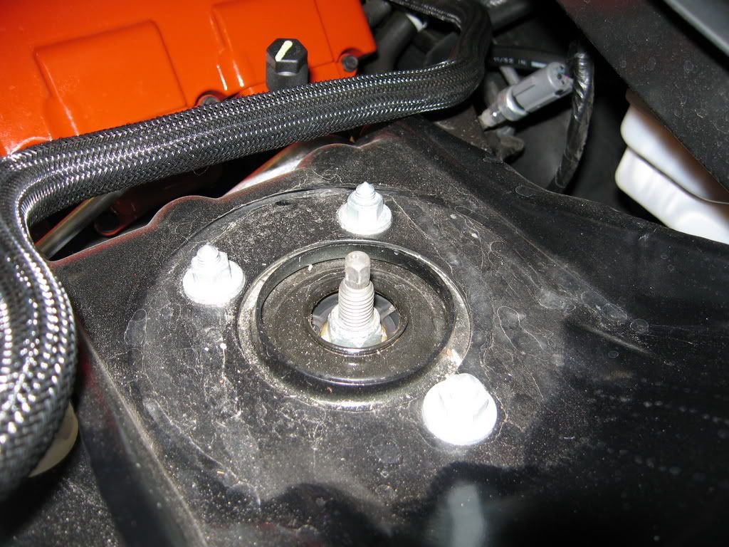

I know that most of the post show using a spring compressor on the front struts PRIOR to removing the strut. This is completely unnecessary. The top plate on the strut holds the spring in place. So when removing the strut remove the top three bolts, leave the middle one alone and remove the lower strut bolt and the sway bar link bolt.
Remove the upper ball joint nut and split the upper a-arm from the spindle. I used a gear puller instead of a pickle fork. Much less chance of hitting the car. After that you can pull the entire strut and spring unit out.
Now you can get your spring compressors on there and compress the spring much easier than doing it inside the wheel well.

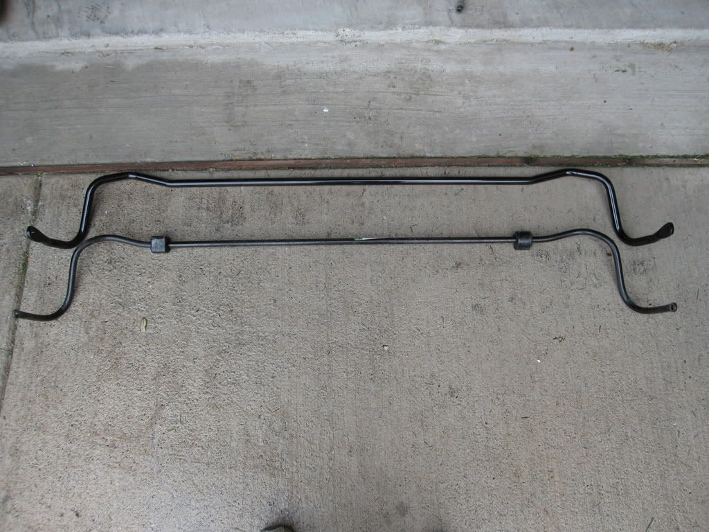

Anyways, you can see the difference between the stock sway bar and the Hotchkis.
Front:
Rear:
