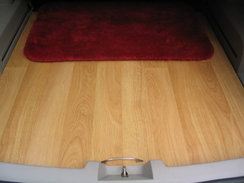

First one was wood decking in the back. Just left over flooring from when I did my basement.
I just took the rear cover out layed it over the snapped together flooring and traced it. Got a handle from Home Depot for $3.50 and with some Velcro strips for a couple of bucks. I stuck the both halves of the Velcro to the second section of the cover and layed the flooring down on it. Now when I lift the handle on the flooring the cover comes up with it and folds like it should.
This is mainly for the guys that use this position to haul bags of stuff, and yes the hatch closes with it up. I keep a couple of red bathmats in the back to keep things from sliding around because the flooring is slick.

427 Posts
I have seen a couple mags with the wood layout in the back. I like that one, though my favourite had more of a surf board syle look...
I think I may look into the wood trunk floor idea!
