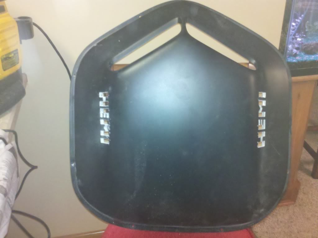

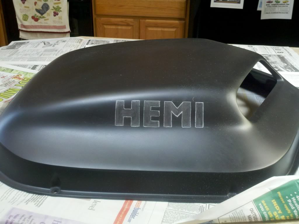

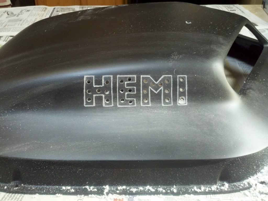

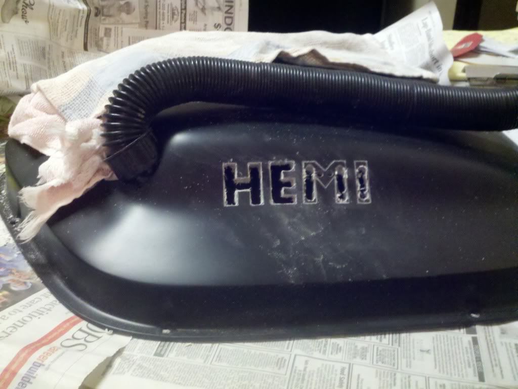

Heres a Peek at what is happening with the car...
Test fit

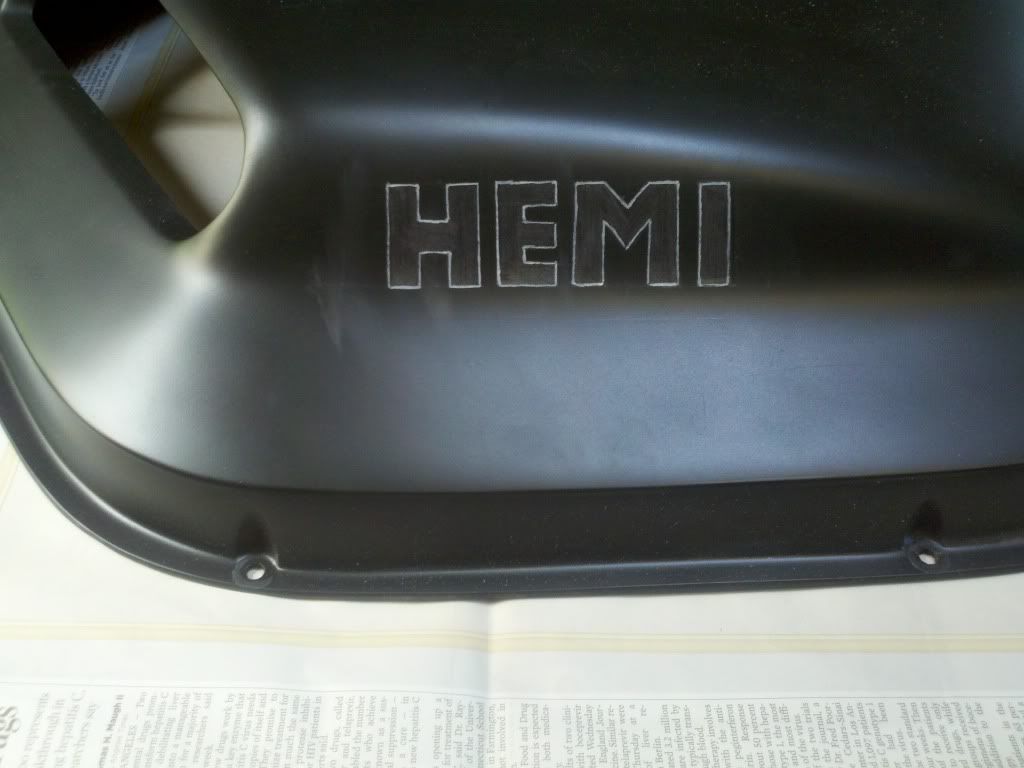

Pre drawn

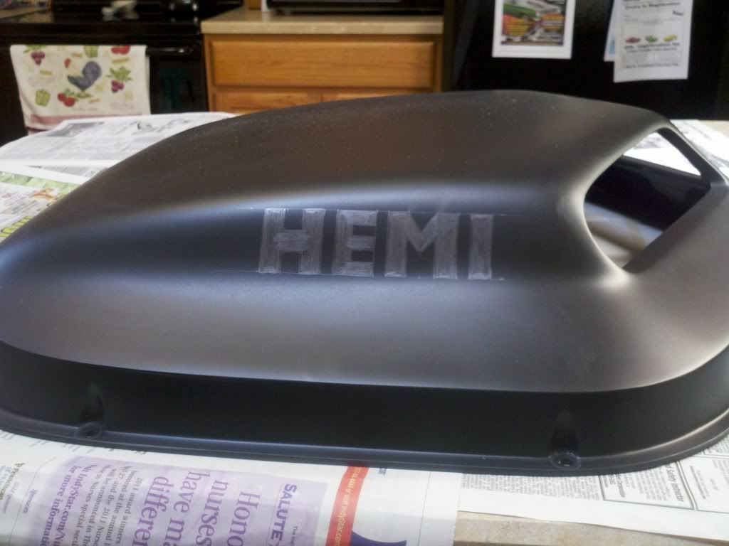

Etched outline of letters left side
Etched letters Right side

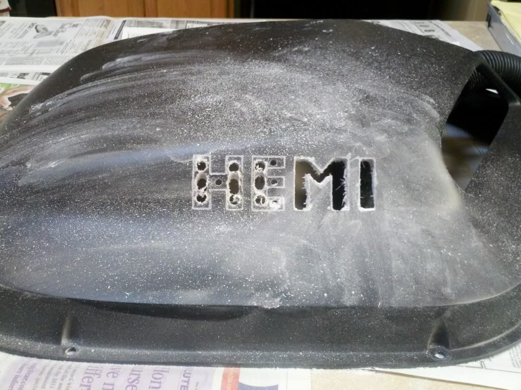

Holes Drilled Right side.
Dremel cutting in progress

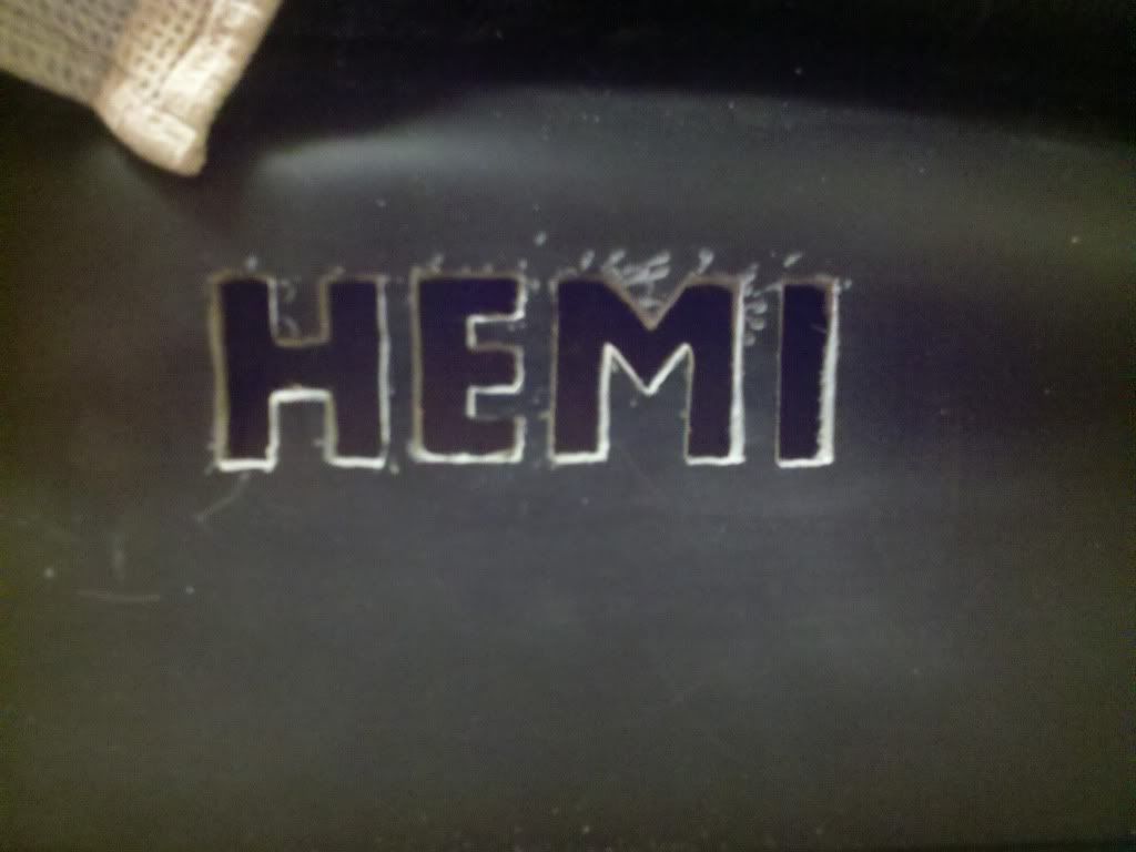

Dremeling other side
done with all cutting
Work area
top view
Idea behind it all

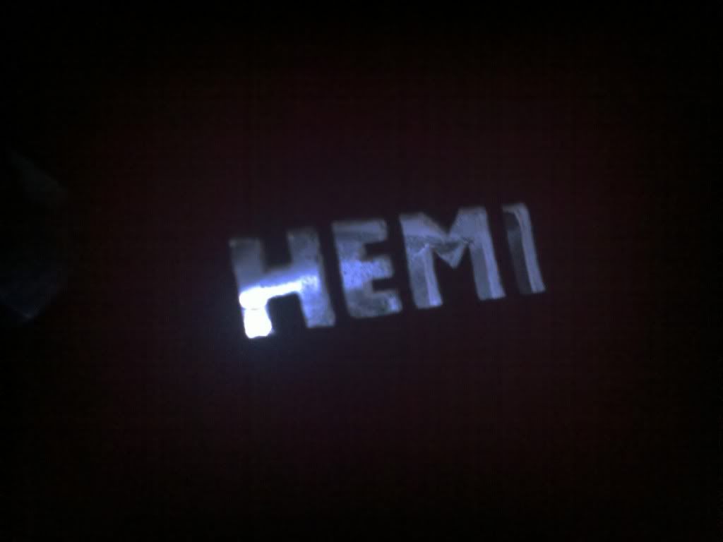

Tomorrow or Friday I will take a little fiber resin and smooth the inside with a light coat so that it can be painted and take it back down to brett on Sat morning. After paint it gets a peice of quarter inch plex with leds to light it so it will look this way when I turn them on... :modding:
