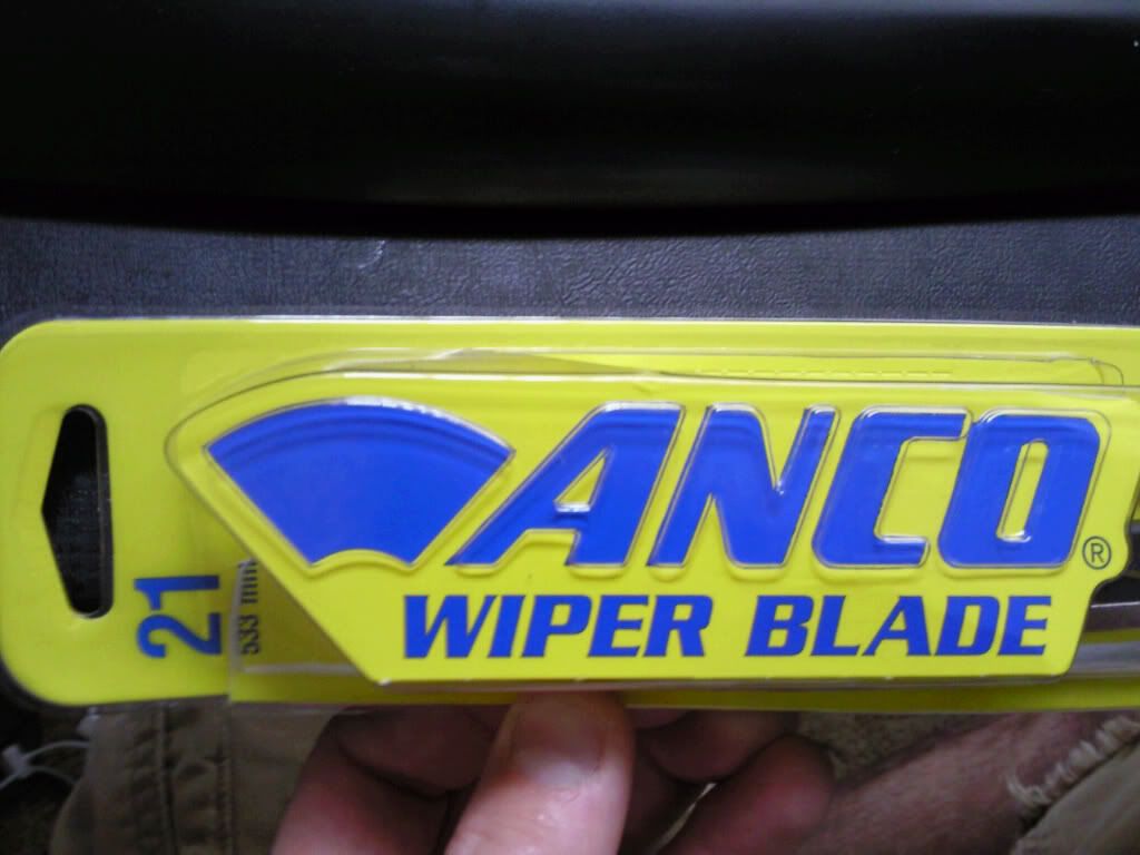

Step 2 - Grab your new wiper assembly. I used an "ANCO" from wal-mart. $4.97+tax. I got a 21" so that I can have a spare blade. Plus, all the sizes were all the same price.
Step 3 - I used my pliers to snap the retaining tab off of the NEW wiper assembly since all I'm needing is the blade. Then I slid the blade and ribs out. Discard the NEW wiper assembly if you want.
