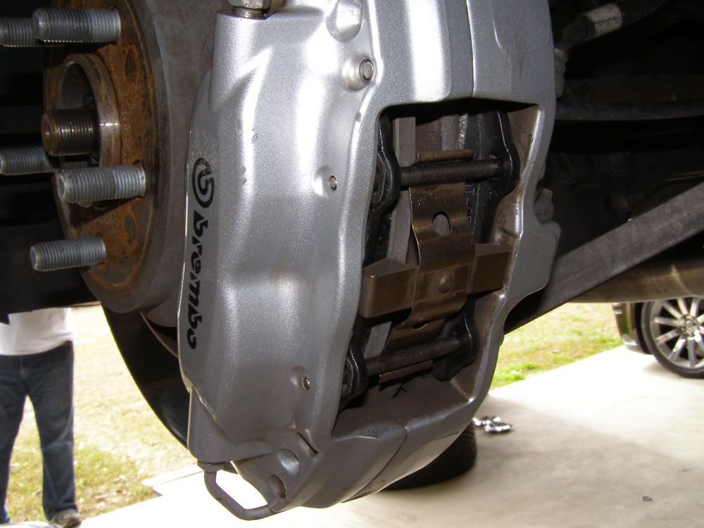

2) Once you have the wheels off this is what you will start out with:

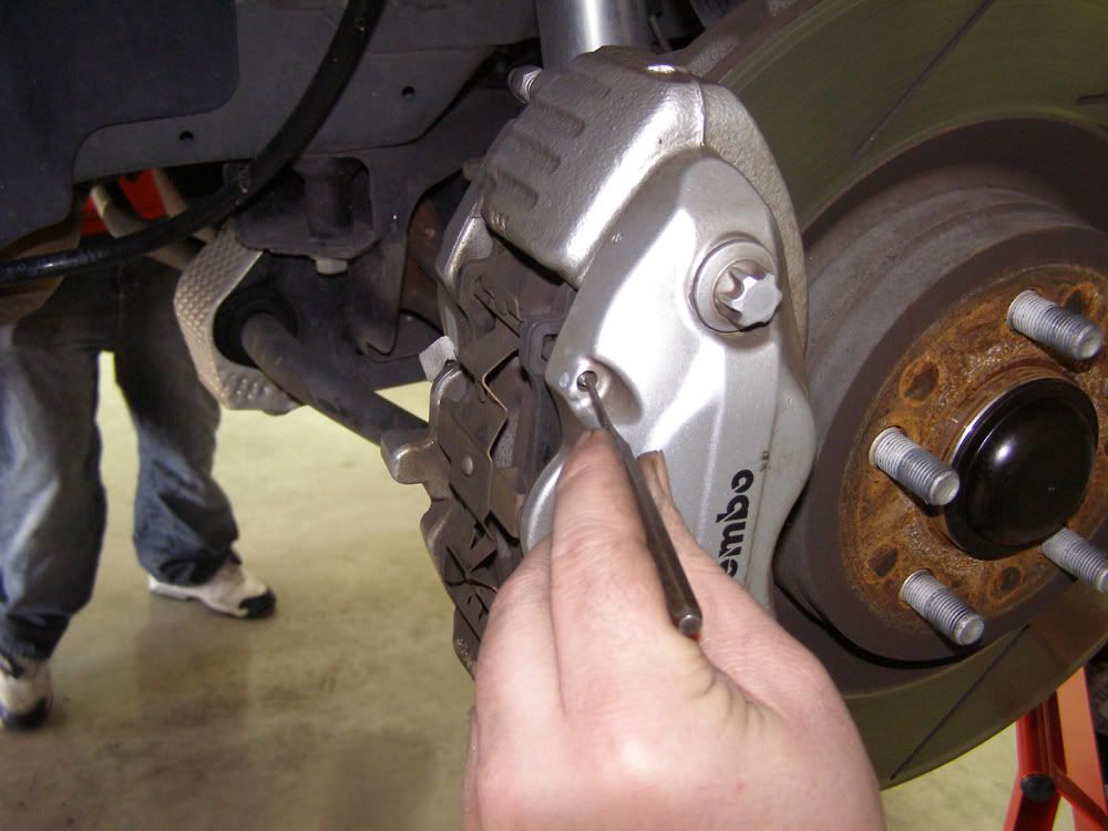

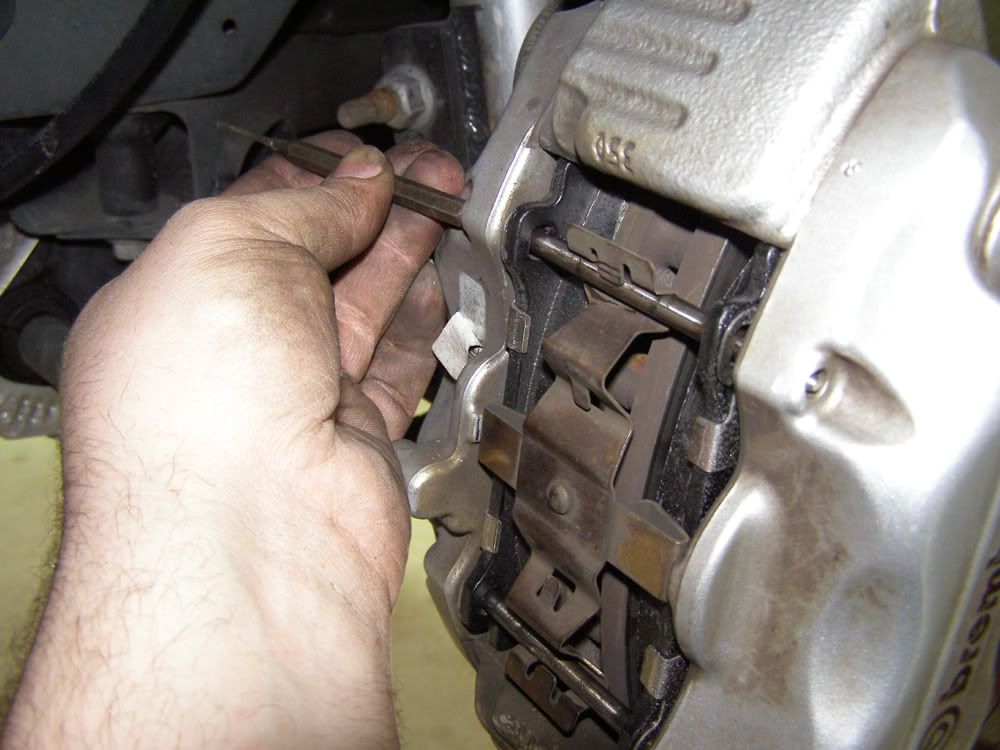

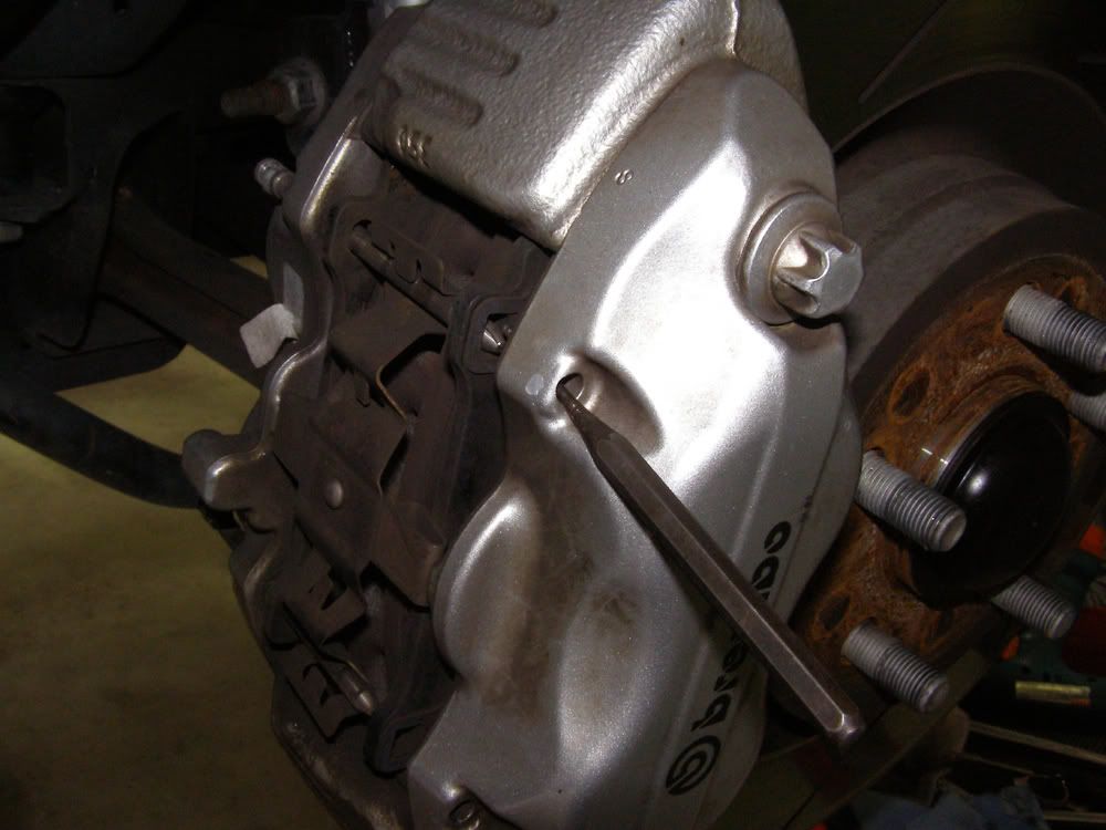

3) Take the punch and hammer and punch out the slide pins

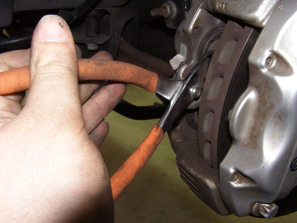

4) Now, some people have bought or rented a pad spreader from stores and vendors. I think it's a waste of money. Use the large pliers and open them up like below. Take both hands and open the pliers which in turn will spread the pads a good bit. More than enough to get the old pads out.

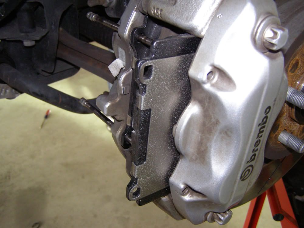

5) I didn't get a picture, but; Remove the pads now. They will just slide out, you may have to give them a little shake or jiggle.

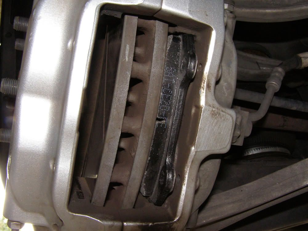

6) Once they are out, take the pliers you used earlier and open them up and insert into one side of the caliper between the pistons and the rotor making sure each end of the pliers is against each piston. Pry against the rotor slowly to compress the pistons; then do the other side. See below

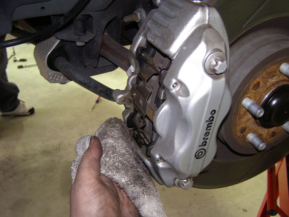

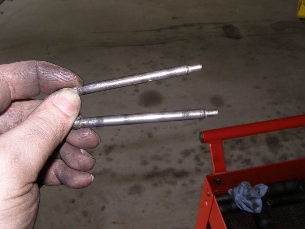

7) Take the slide pins and clean them up with a rag and take some of the grease supplied with most pads and put a light coat on them slide pins. This helps the pads slide back and forth easier!

9) Once the pads are in, put the slide pins in and tap into place. I find it easy to turn the punch around and use light taps with the hammer to tap them into place!!

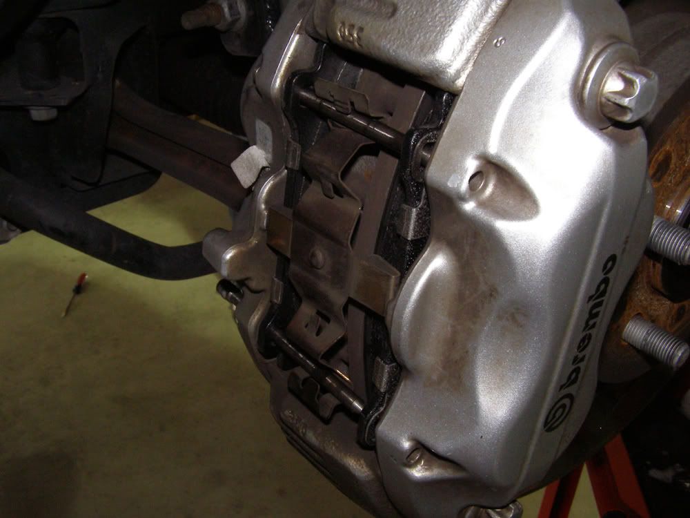

Viola... that corner is done and it should resemble this! Granted the pins aren't all the way in, but you get the idea, lol

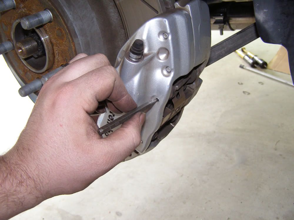

Use punch and hammer to punch out and remove slide pins
