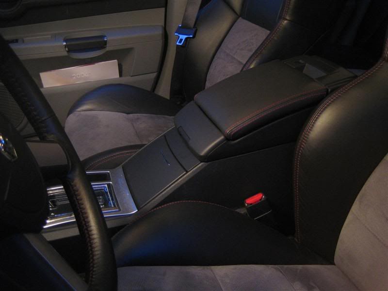

It's not standard on the SRT8 Magnum, but is for a 300 something. (I don't know which one...) I sent a picture to Adam at Eastway, told him what I wanted, he went out to the showroom and looked for the right 300 model and ordered them.
This picture is Bo's if I recall correctly, and that's what made me get them! It dresses up the doors a little and fits right in...

The swap is fairly easy. Pull out the visible door pins (press the center of them in until you feel/hear a small click and then they're loose enough to come out. Undo two screws under the little plastic flaps (two on the front doors anyway, don't remember the back) and then carefully pull the panel off straight back, disconnect wires and then it's a couple of torx bolts to change the door pull.
Stock SRT8
300's Door Pull
One bolt...
The other bolt...

That center console looks different than mine too...is that a 300SRT?
It looks like it would hold more crap too...hehe...just what I need!

Yes, they're 300 door pulls. The center console that looks different has the VES in it.
05170622AA is what's installed on mine, in the pics above.
