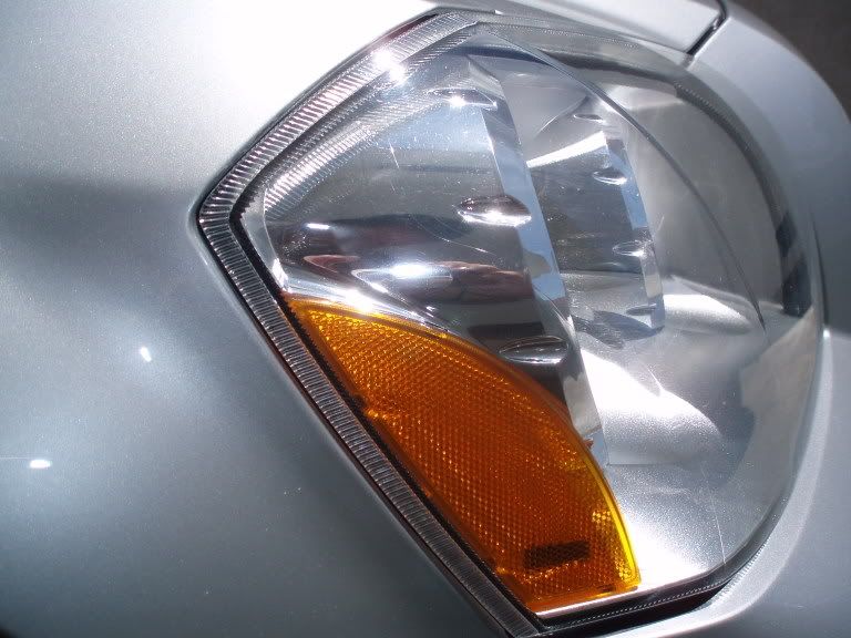

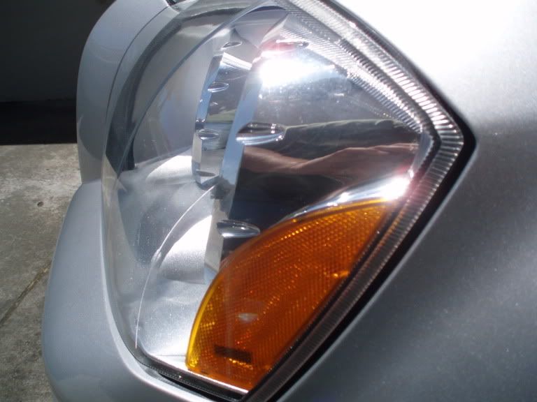

while installing my silver turn signal bulbs, I noticed a little detail that annoys the CRAP out of me. (OCD) A gap approx 1/8"-3/16" between the driver's side headlight & fender. I unfastened the headlight & tried to push the fixture in closer but it would not budge. I know I'm the only one who will probably notice this, but it REALLY bothers me. Anyone have any similar problem? Any ideas on a fix? I'm sure dealer will tell me it's within factory tolerances. Take a look!
Driver's side with gap:
Passenger's side without gap:

Mine is the exact same way. Dealer said as you stated. Guess we have to live with it.
