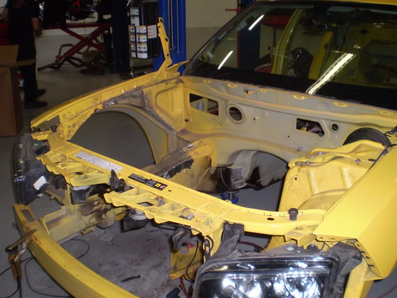

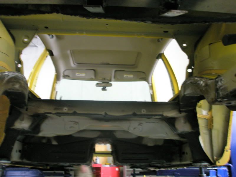

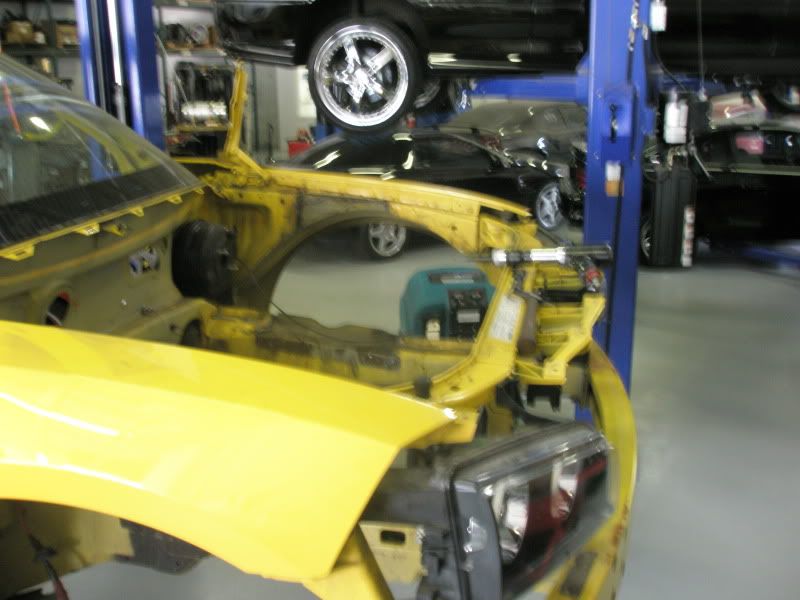

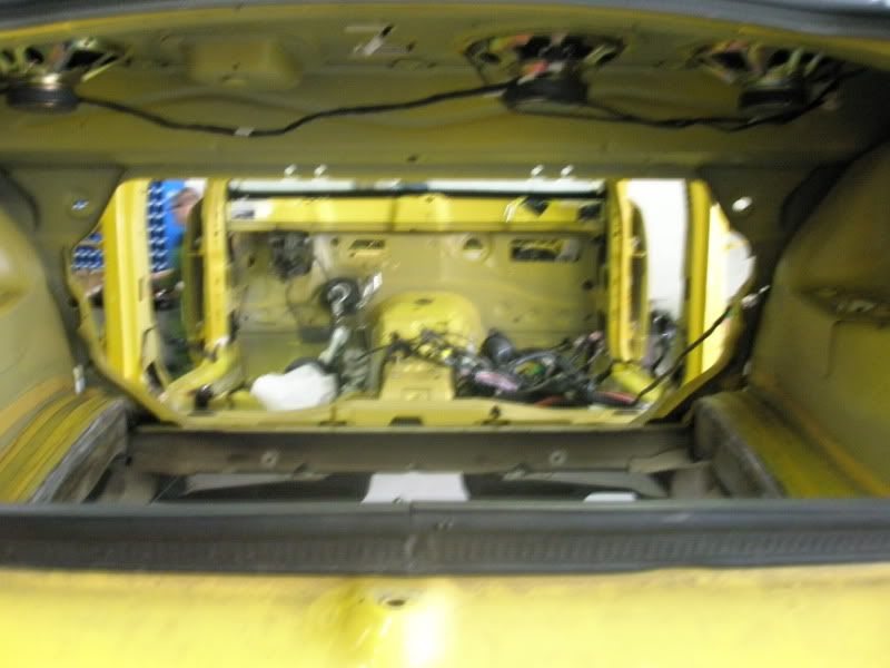

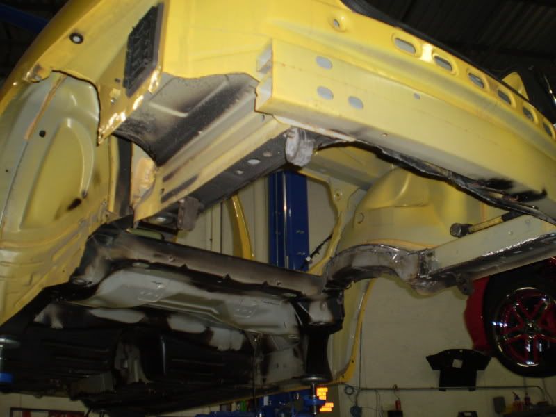

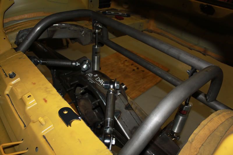

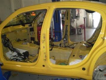

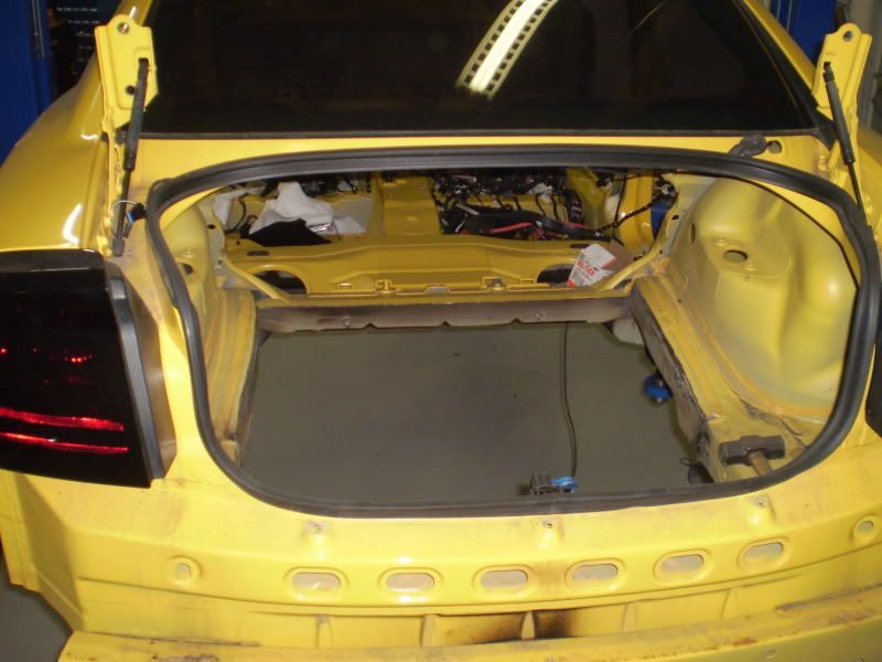

Here are a few pics of weight reduction that is currently going on.
Here's a little teaser posted by Justin.

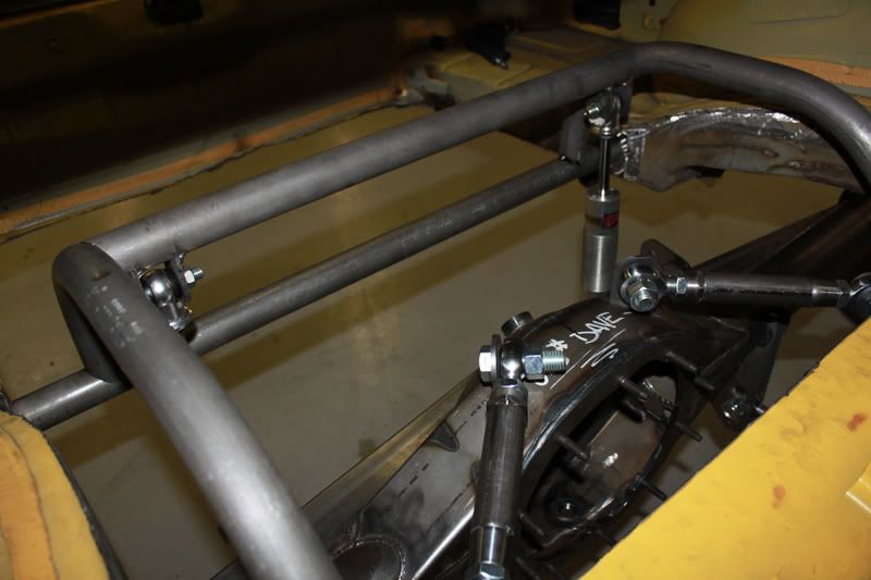

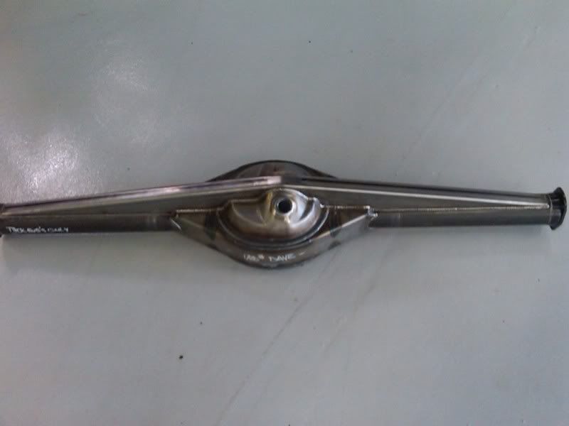

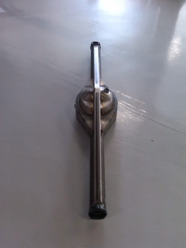

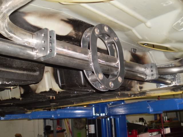

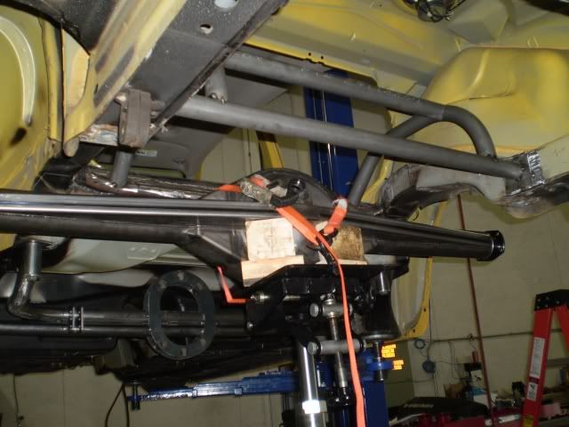

Here are a few pics of the rear end we picked up from the guys over at VRN. (Custom Back braced Fab 9')

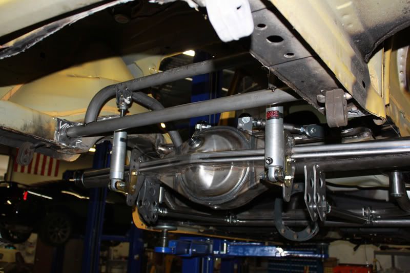

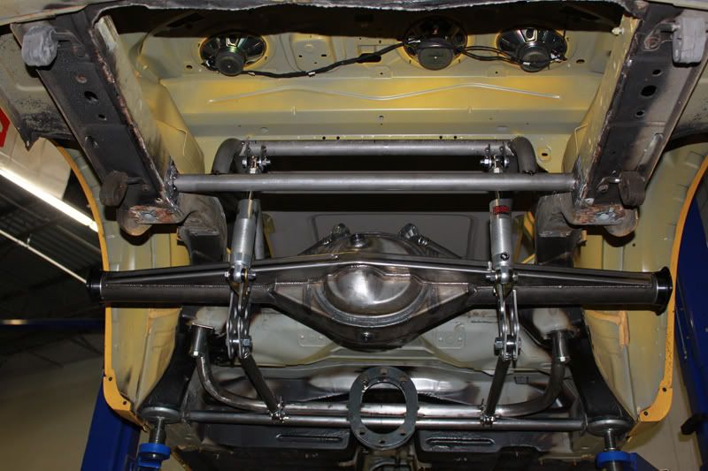

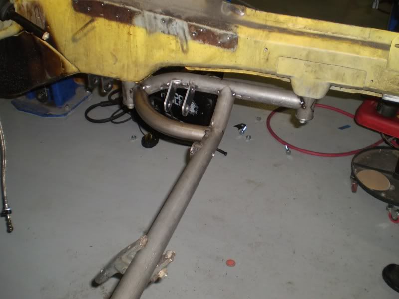

Lower trailing arm mount and cross member. You can see where we're going with the drive shaft safety loop. (go Justin Go)

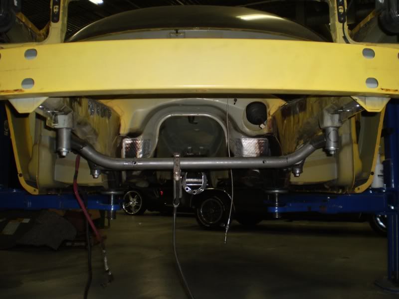

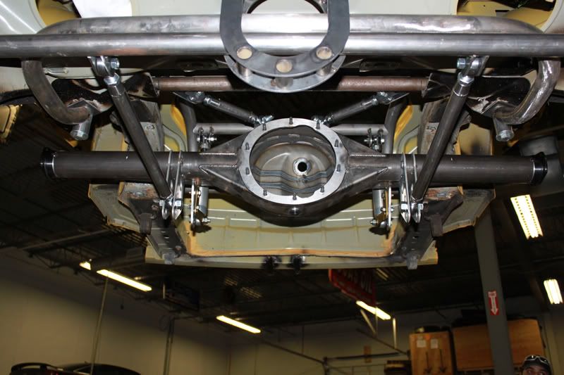

More progress on rear "subframe". Structure for the sway bar and coil overs is now mocked up.
Here are a few pics of the progress on the rear housing.

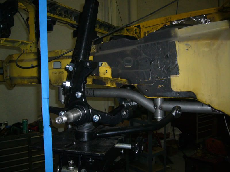

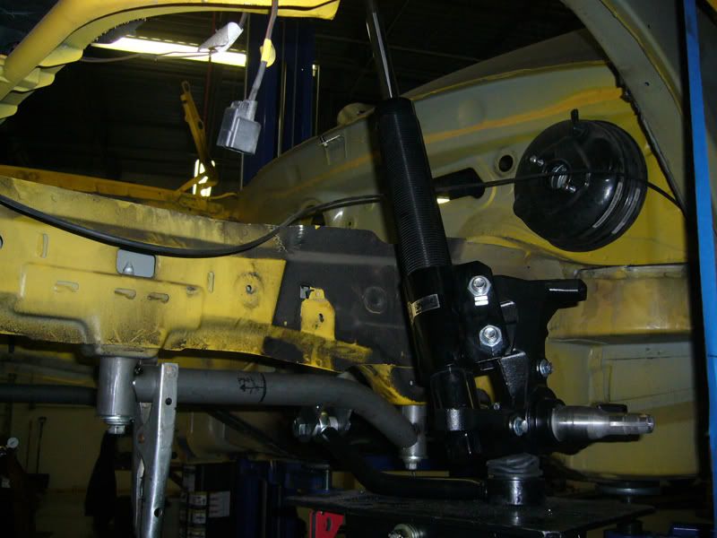

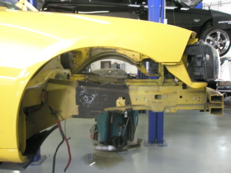

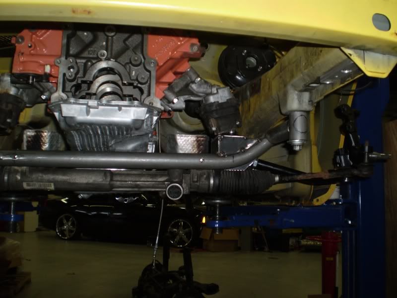

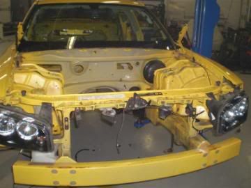

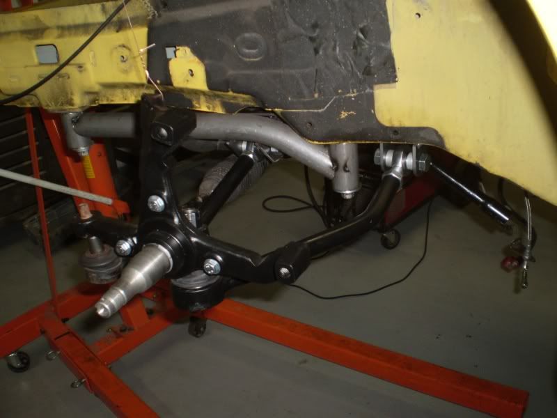

Front end Updates

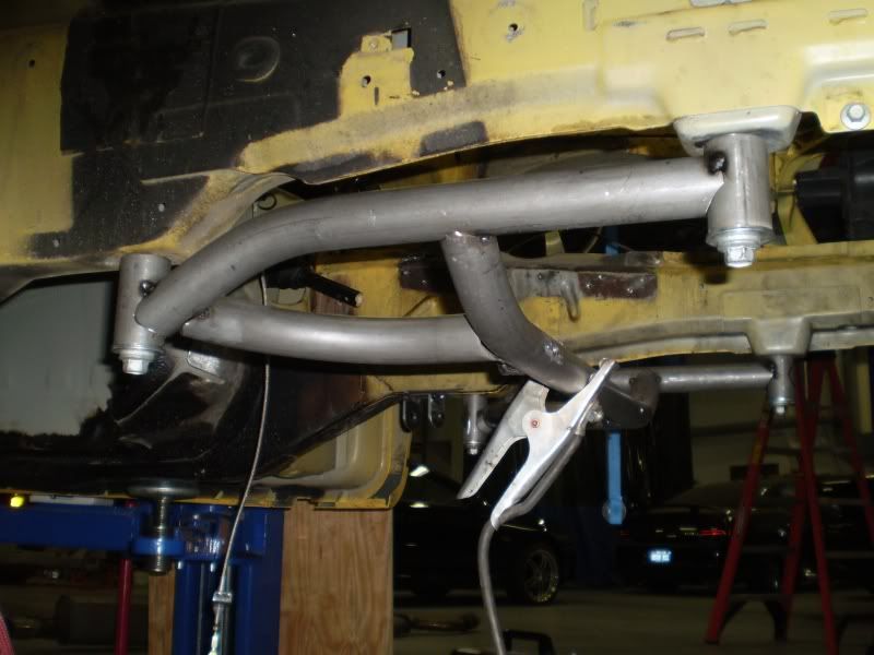

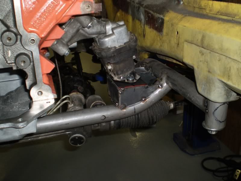

Here are some pics of the front K-Member

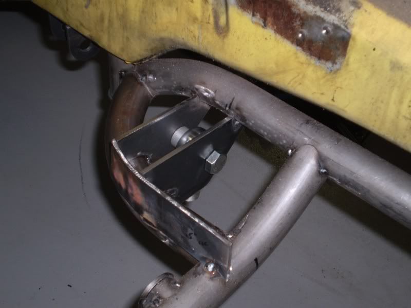

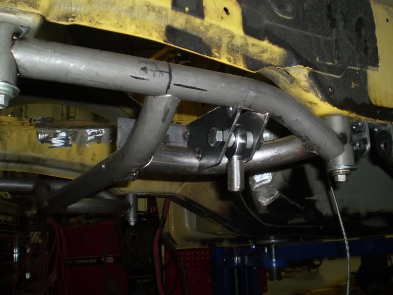

Here are some pics of the battle box for the lower control arm and this will also serve as the motor mount pedestal.
Rear End And Suspension

Tubing and front control arm will be at the shop tomorrow. Time to get the tubing bender out. Short week this week, but this project is a priority for me. Time to test the old ME degree! Going to be mocking up the front geometry first and then creating a rear subframe for the rear end.
885 Posts
Oooo, sounds good justin can't wait to see some pics, no big hurry though we got a loong time til' race season starts up again :)
As soon as I start thinking that way, spring will be on top of me. Designing the details is one thing, and then there's all of the work to finish weld it and put her back together. Lots to do. Can't let it sit idle.

Well if you can please do, I know many are curious what a shell alone weights and how much weight you were able to remove.
Maybe we should go take a pic of the four of us lifting it. Justin, Phil, Mike and Myself should suffice don't ya think?
