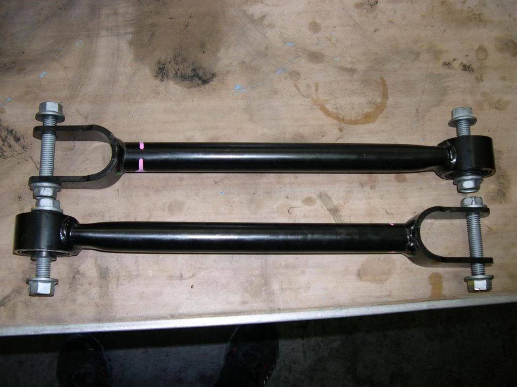

Dodge Challenger SRT8 fully Pedderized!. A pictorial documentation
The Differences of the Chally suspension from the other LX's are below.
Tubular Trailing arms
Rear Bilstiens, Springs

Nice!
Very cool Chris

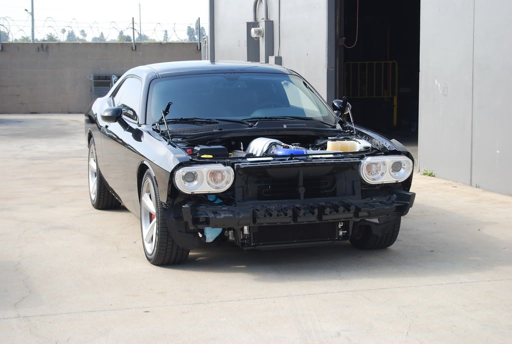

So we move on with this build.
We removed some body parts for some unknown reason :blam:, I've had a hard time sleeping while these have been gone, Im supposed to get them back tomorrow,
Then these arrived with some Hi-Flos cats, Fresh from KOOKS with the step up 1 7/8" to 2" Design, All coted and ready to go!! Thanks HHP!
She got flat beded to a fab shop for some work, Here she is ready to go into surgery. She should be ready for pick up friday!!

Congrats on taking baddest 300C.
Looking forward to seeing the results and I see your Challenger is following in your 300s footsteps.
Who's going to be doing all the work on it Chris, Looks major especially with the engine comming out
My good Ol' Buddy Cam :not_worth and myself are gonna do the Motor swap, Cat-Back, TQ Conv, And wire up all the new Innovate Gauges. 3 day event Id say, Cam say's 2 day! :doh:
Well I know everything will be done right with Cam at the helm
For sure! Im not even sweating the work Cam's gonna do!
