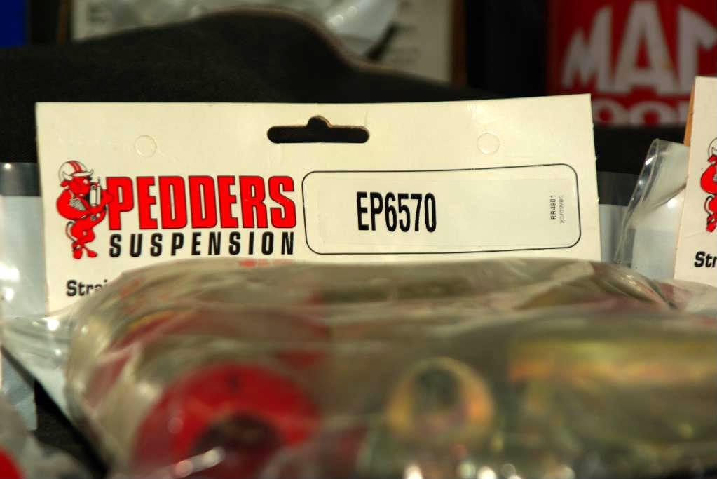

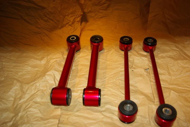

Here are some pics of the parts...
LX Front Upper Control Arm Bush (adjustable)
LX Front Radius Rod Bush (tension strut bush)
LX Bump Steer Correction Kit
(EP4107)-LX Lower Front Shock Mount & (6568)-LX Front Lower Control Arm Bush

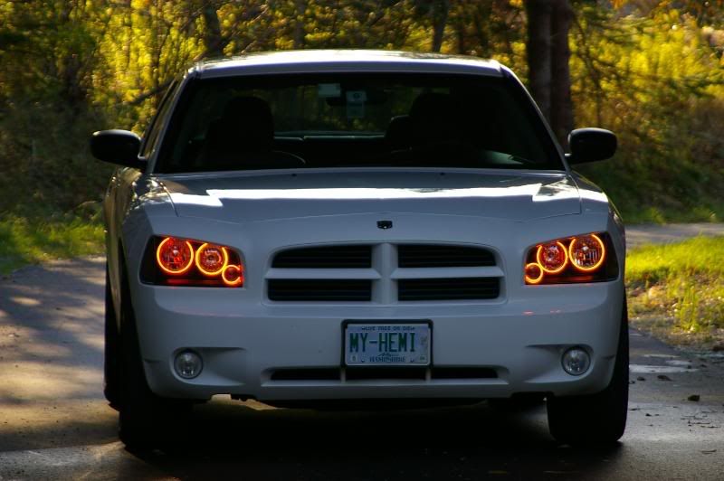

Well, I did the CCFL Halo thing over the Columbus Day weekend...
Only took about 14 hours total and 2 sets of headlights (between baking a used set already in hand, another headlight shipment, baking again and install)..................
(TIP, DO NOT put the headlight covers in to reheat to clean up the sealant face down on the HOT rack in the oven!!!! They warp and bubble up, ya know? :doh: Especially when it is directly over the heat source in a gas oven)
They look really killer!
The only down side is that they were in for 2 weeks and now the high beam on the passengers side is broken! I assume that it is broken because I can see a dark line at the bottom of the ring...
So out they come and stock lights go back in. Will need to decide if I go the replacement ring route or just save my pennies for the LED ones next year...
SEE POST #16 FOR THE LATEST ON THE HALO INSTALL!!

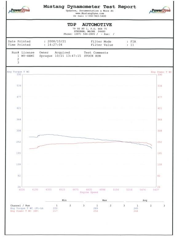

Had a custom CMR tune/dyno tune (Mustang) done while on vacation in Maine last week! Boy was that fun!:racing:
Went to TDP Performance in Steuben Maine last year (2008) and had some dyno runs done with everything stock except for a drop in K&N air filter. Came in around factory specs.
Dyno Result Chart 10/08
Quarter Mile Results 10/08

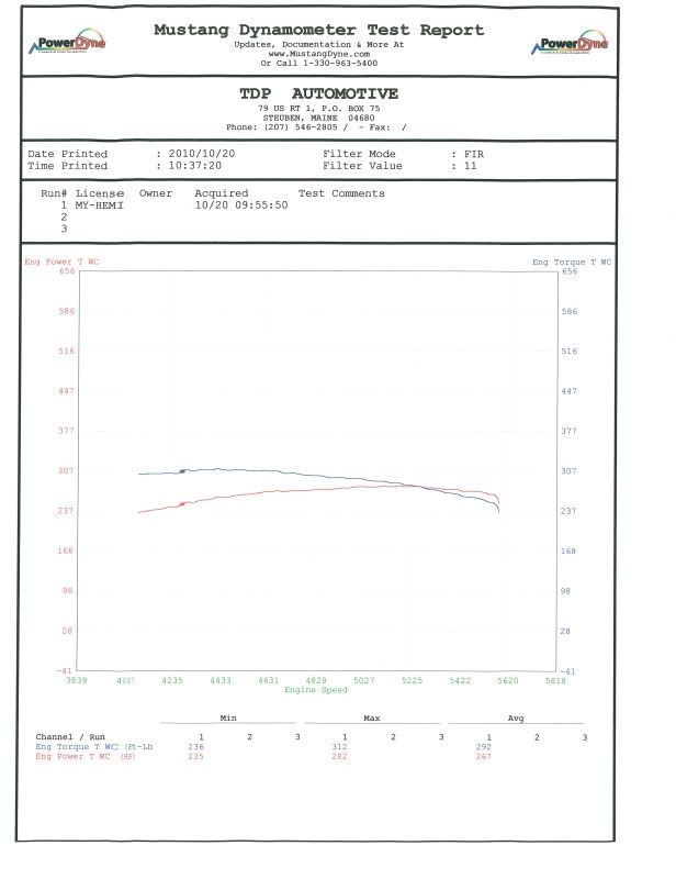

Here are the details from our last dyno run in October (have only used TDP) and the new one after the cam (cam only, no heads/headers or high-flow cats yet).
October 2010
May 2011 - After cam install
