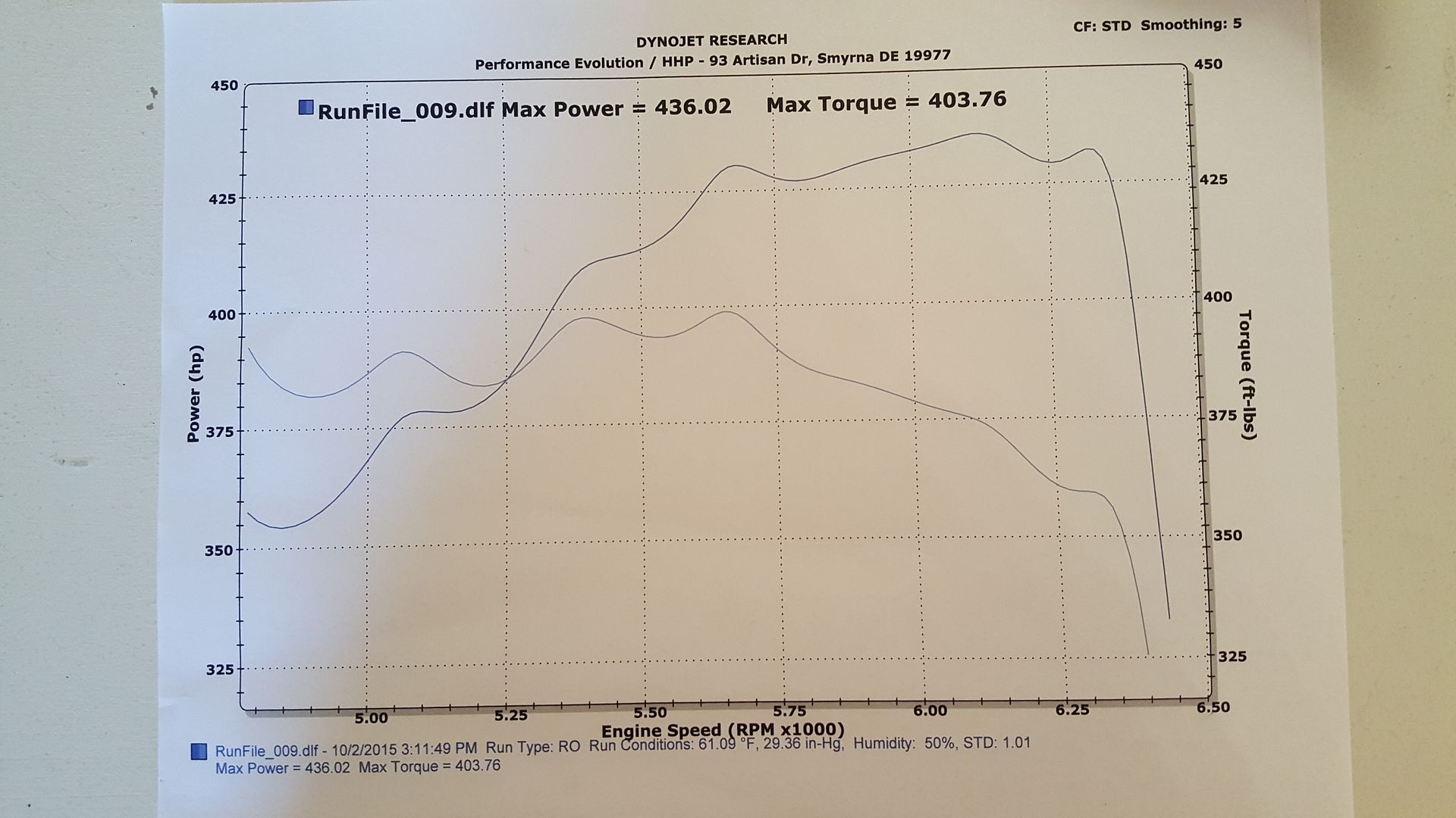

Here are my most recent dyno results after the install of my heads. In addition to a Comp cams 274 Cam, P&P BES/HHP Heads, and P&P 6.1L I have 3.55 gear, FTI triple plate 3600 Stall, LMI True Cold Air Intake, Kook Longtube Headers and Catless mids, and Zoomers Catback exhaust.
Best numbers were 436 rwhp and 403 tq. Overall I am satisfied with the numbers. The combination of the new stall and the new gears really make her an animal. I cannot wait to take her to the track in just a little over a week.

your after sheet does look very strange.
Sounds AWESOME btw
Why? Because of the curve isn't smooth? It was the first couple of runs after the 3600 stall was put in. The computer didn't have time to learn it yet, which is why the curves are not smooth. It's going to he redynoed later this week at a shop near my home.
Also due to the combination of the high stall and the gears you cannot get a good reading until after 4200-4400rpm
