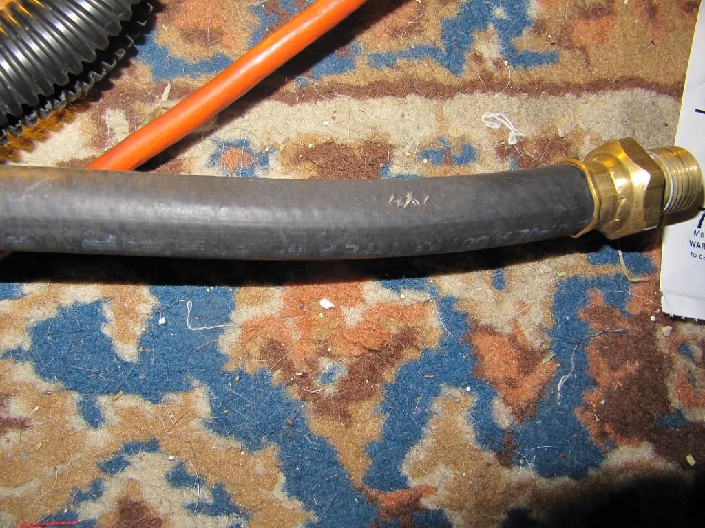

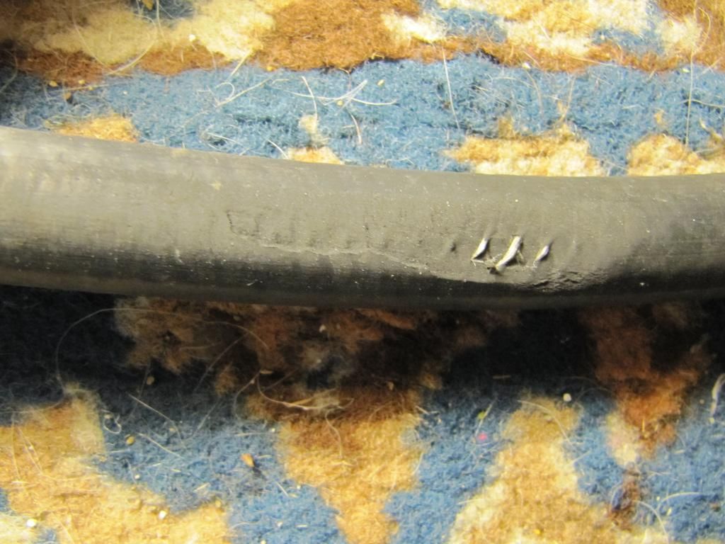

    Last week while inspecting my front system I found this,
    Inner of front tire was rubbing on hard turns

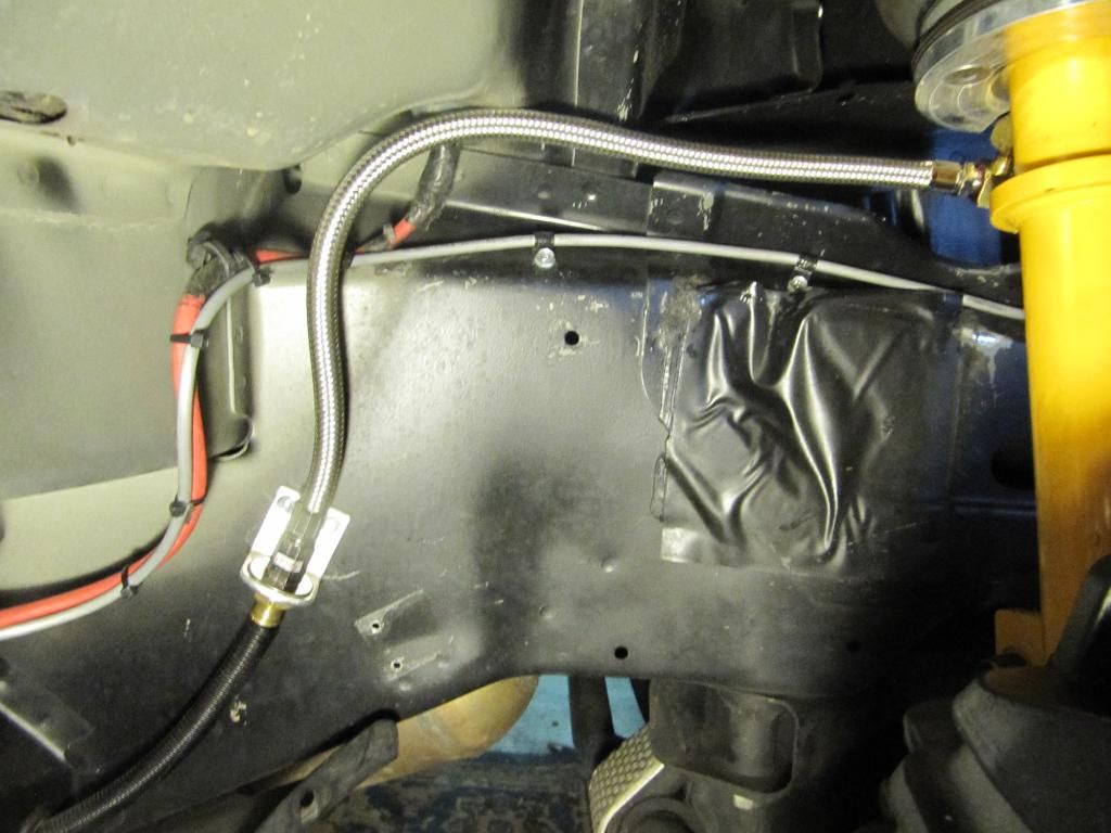

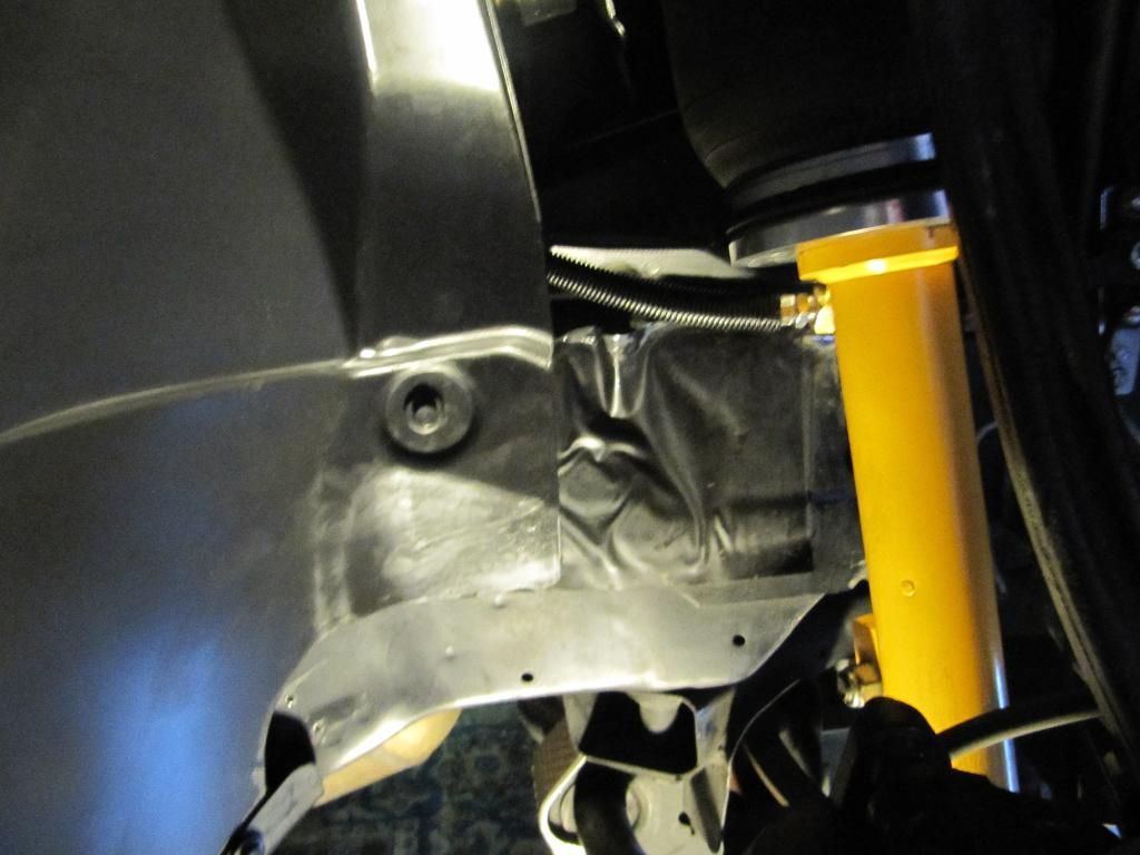

    Here was my original routing

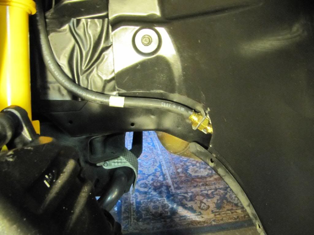

    Here is my new routing, which safely tucks it behind the fender liner
    Replacement complete,braided line was covered with split loom for added protection

    Good info for those who choose to go below that push pin. I see that a lot due to people not taking the time to try to make the fender liner fit after the front lines are installed. The line naturally fits lower, but as you've already shown, doesn't provide the necessary clearance to avoid rubbing. There's obviously a ton of different ways to make that work, but going above the push pin has been good to me on my last 3 setups.
