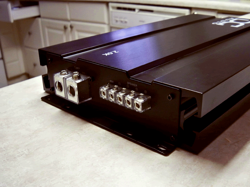

    So then I got my DC 2.0k in finally. And It looked sick!

    I ditched the DC 2.0k and replaced it with a DC 3.5k with dual inputs. Re-did the trunk wall and added Plexiglas backing to the DC 3.5k. I also added cooling fans to the wall. Mainly because I couldn't fit any fans on the DC 3.5k itself. Took out my Factory 750cca battery and but my XS D3100 in its place. As well as adding five Exide deep cycle batteries (same tech as optima just different patents)

    I didn't pull any punches this time around electrical wise. haha....... As you can see I added five Exide spiral tech deep cycle batteries (same tech as optima, just different patents). Each negative and positive has two 1/0 leads going to and from each post. I beat the spare tire area flat and Great Stuff foamed them into place. That black thing in between the bottom to batteries is a piece of leather. The negative and positive there are kinda close so I just put it there "just in case".
    The black wire on the Positive side of the XS D3100 is the 1/0 Knukonceptz running to the alternator. The light red one next to that is the factory 1/0 that also runs to the front of the car and splits off before the alternator. ( Don't worry about that black tape lol.. its just temporary.. The D3100 sits a little high its just for safety. I'm working on something more permanent.)
    The battery bank starts at the top right hand Exide battery (positive and negative are rand from that battery to the D3100) and ends at the bottom right battery which is also where the amp dual inputs are as well. ( I didn't fuse any of the batteries due to them being so close.. That should be fine yeah? Or should I at least fuse near the D3100 and the Exide?) There are two fuses on the alternator lol... Don't worry.
    I also replaced my Stock alternator with a MechMan 240a alternator. According to the testing paper it does "142a at low rpm speeds and 252a at high rpm speeds." I could defiantly tell the difference as soon as I started the vehicle. The alternator on my 300 is on the bottom.. No worries, I have a car lift at work at my disposal muhahahahaha.
