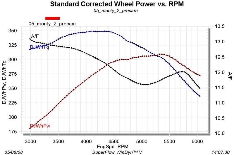

    PRE-cam Dyno (Airhammer gen1 intake only - and 20" Foose wheels)
    Recent Dyno (Just after the SRT headers, Magnaflow cats) :

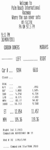

    And the recent timeslip (prior to 3.06 gears and Edge 3200 TC):

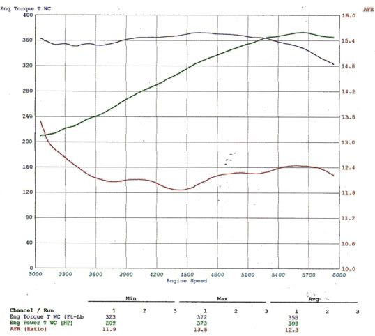

    Here's the dyno sheet after the Eagle heads and 6.1 intake addition. This was done on a Mustang dyno, in 92+ degree summer heat... (05/21/11)

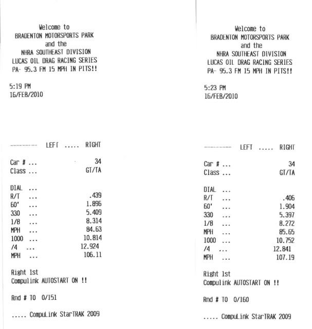

    And here's my latest Timeslip (after TC installed back in May )
    Aaaaand my latest timeslip from Bradenton (Right lane - 1D ) :

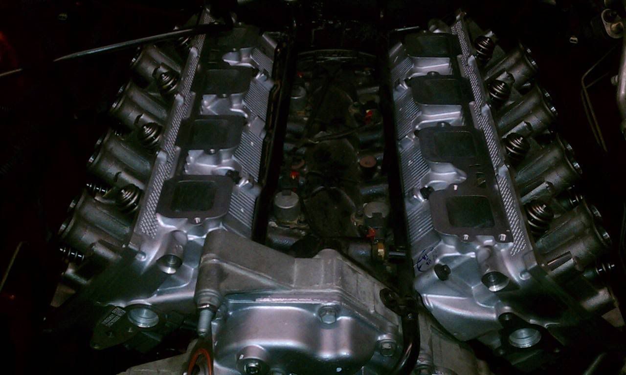

    UPDATE: 02/05/11... The Eagle swap.
    Summary:
    Eagle Heads (stock, untouched)
    Modern Muscle gasket(s)
    coilover conversion
    6.1 Manifold
    6.1 lifters
    etc etc..... see threads below for more info:
    The Eagle Swap Planning thread here:
    https://www.lxforums.com/board/engine-intake-exhaust-performance/222470-eagle-intake-manifold-eagle-heads-05-5-7-a.html
    The install by Afterhours Mopar Performance thread:
    https://www.lxforums.com/board/engine-intake-exhaust-performance/253624-amp-knife-eagle-conversion.html
    Aaand I cant forget my new sig! LOL!
    Results to follow soon! Tuning in progress!
    Aug 2005
    Pompano Beach, Florida
    15,797

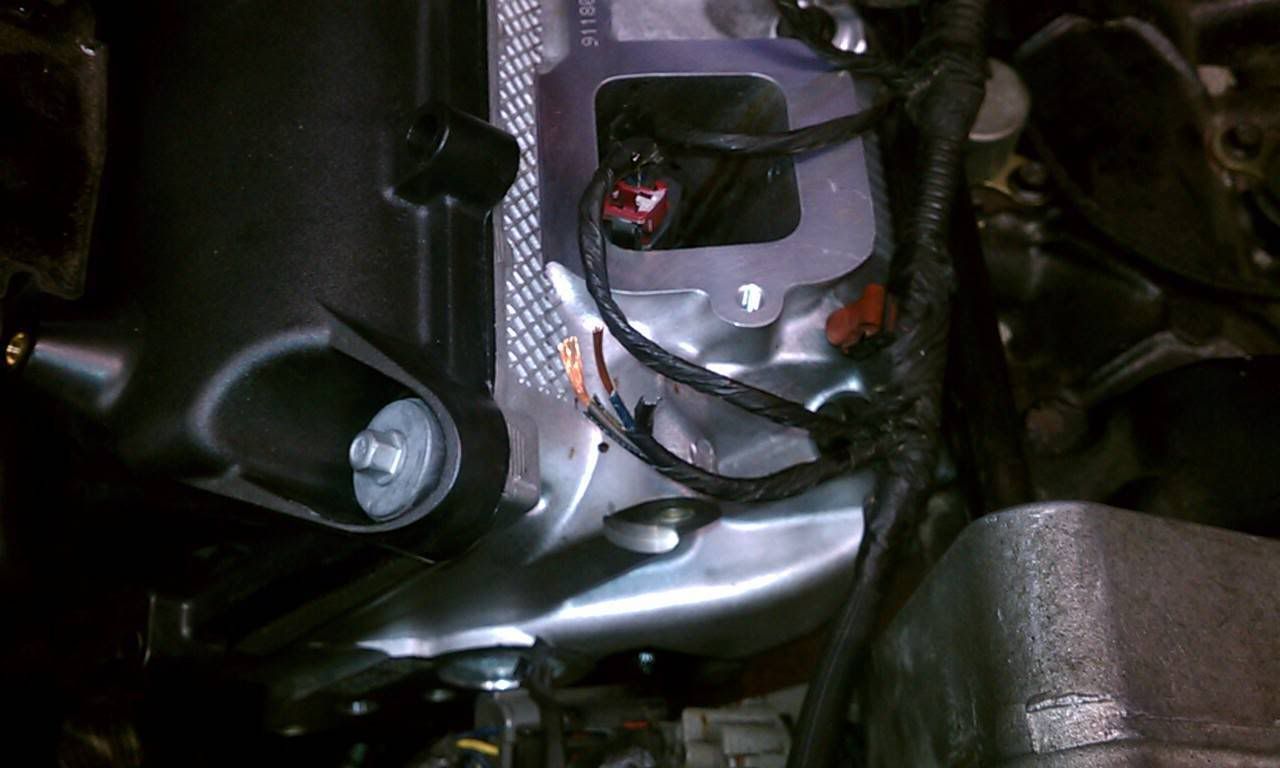

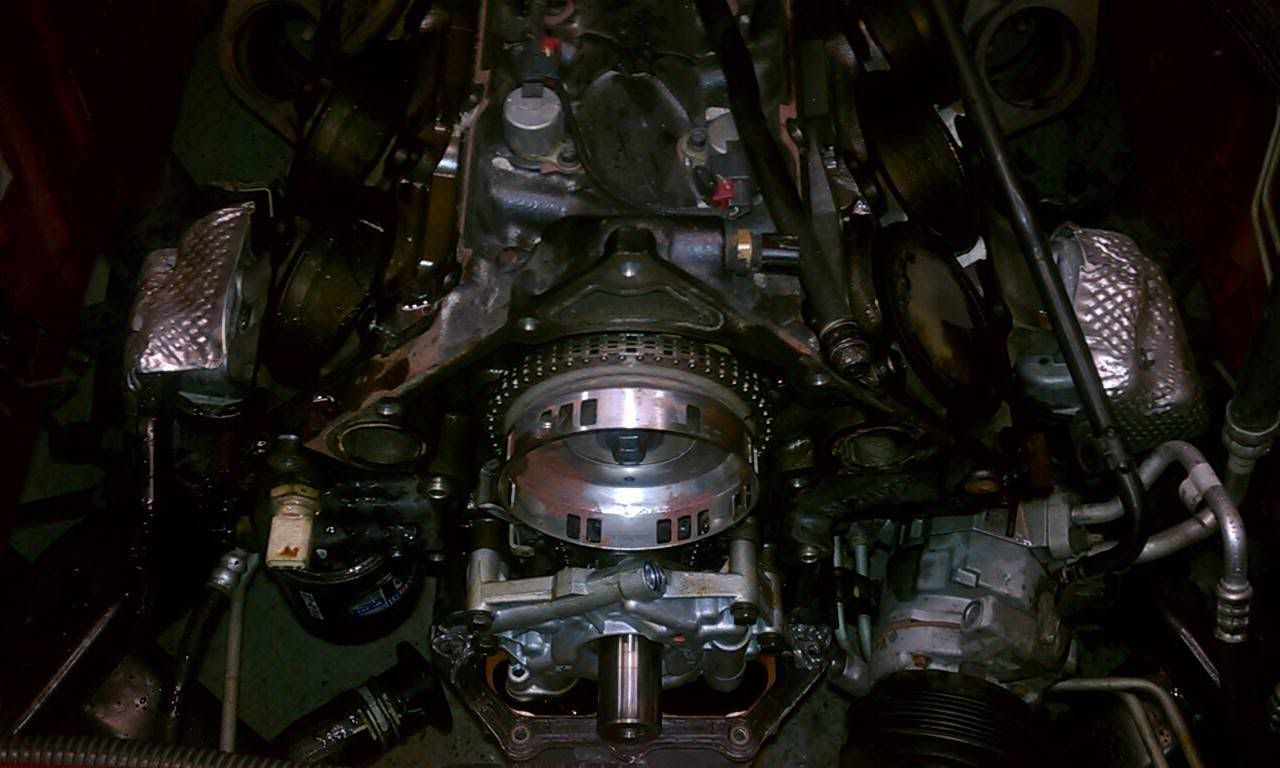

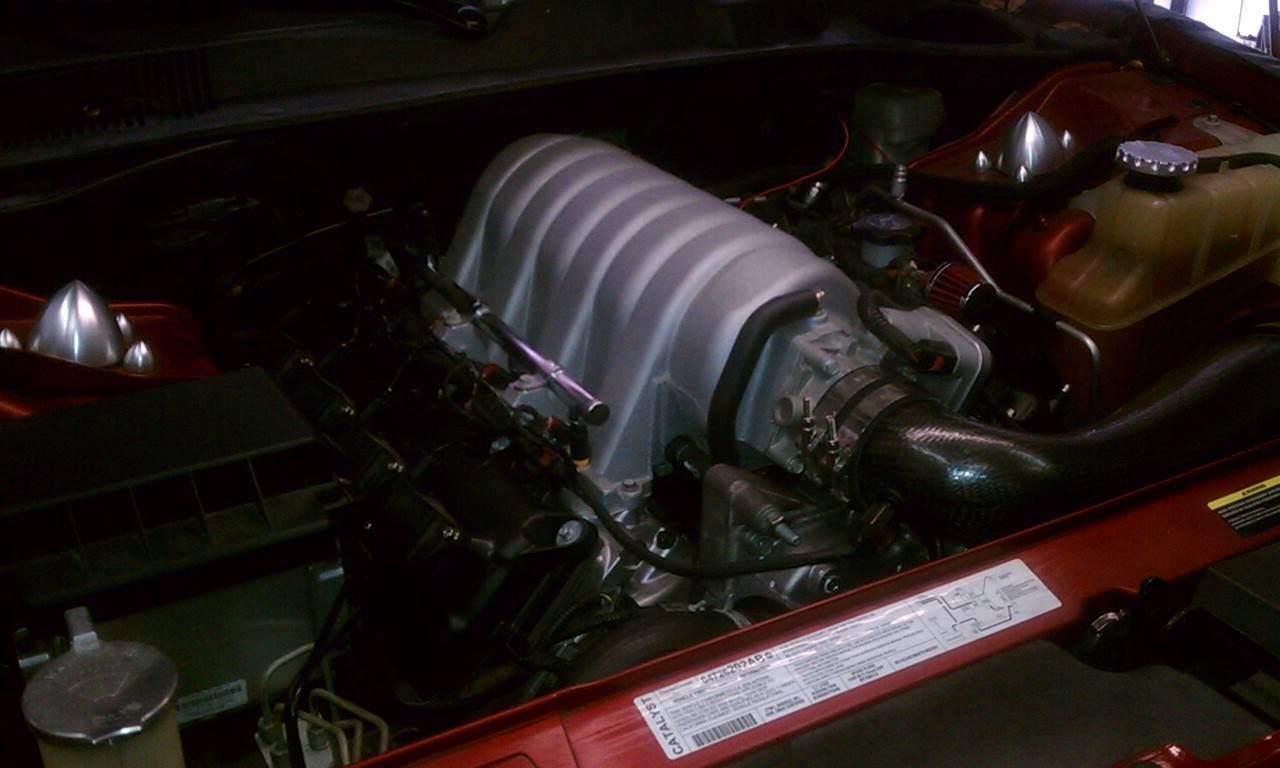

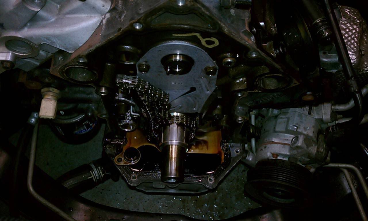

    The write-up:
    Almost Valentine's Day... decided that she needs some luvin'. I took the girl to Afterhours Mopar Performance and let Scott and Jon have their way with her.
    Here what she looked like when I dropped her off. Gentle and innocent in a factory-ish sort of way:
    We put her up on the lift exposing her for all the world to see. Look! No thong!
    Anyways... I left her up there; getting the F_ out of the way... Scott/Jon touched her all over... inside and out... fondling her at times... man-handling her when she wanted it - and believe me, she wanted it! I kept getting updates throughout the night. Dirty little pictures sent to my cell phone... like these showing her..."insides"
    Next they gave her head... Eagle heads (non-ported, stock Eagle springs, custom rods)
    As you know, some girls are a little more ...complicated... than others. This one needed some styling on the wiring harness and fancy new coilpacks. (coilpack differences between the '05 5.7's and the '06+) Jon is the expert here, so he did a lot of touching, making good solid connections right where she needeed it most.
    At this point, the boys fingers were tweaked for the night and the girl would get another day of man-handling.
    Last minute change: With some excellent assistance from Dave at Modern Mopar Performance Group, I was able to finish her off with an SRT intake manifold! She would definitely be able to suck a LOT better now! Especially with more room to grow...aka 426!!
    Scott/Jon were in the home stretch... Rouding third base... Heading for home!
    Here she is all buttoned up...
    I got back to the shop around 8pm Saturday night - Scott/Jon waited for me to get there after several hours of hard work with minimal sleep and Scott being sick. Needless to say she whooped on 'em pretty hard. I think I saw lash marks on Jon's back; but he was smiling about it.
    I'm still doing more mods to her and plan on completing the tweaking process with Johan on the rollers real soon; Yes, Johan likes playing with her too!
    I'll keep ya'll posted!
