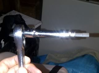

    8mm Hex Socket

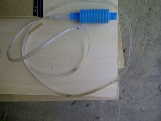

    Siphon Pump with .25 tubing ($1.99 at Ace Hardware or Autozone)

    3/8 ratchet with 3 inch extension

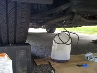

    A container to capture fluid, I used an empty water bottle jug, one gallon.
    Drive car up on ramps or use jackstands. Remove the plastic cover by unscrewing 4 10mm bolts.

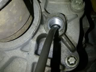

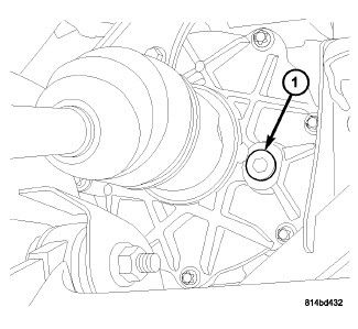

    Using the 8mm hex bit and ratchet w/extension, unscrew front axle bolt, located on passenger side, just in front of the axle
    ...it may be a little snug but shouldn't prove difficult to loosen. No fluid should spill out but prepare for some drips, just in case. FYI, nothing came out of mine.
    Insert siphon into hole where bolt was removed, about 4 inches or so makes it in.
    Start pumping the siphon to draw out the old fluid from case. Move the siphon tube around, while pumping, if you don't see any fluid being drawn out. Once the fluid starts flowing, just pull off tube from the pump and insert into your container...let gravity do the rest.
    Once fluid stops flowing, you know its empty. Be sure to measure the fluid thats come out to be sure you have gotten everything, just in case the hose was moved somehow and didnt capture all the old fluid. It should measure apprx .6ml of fluid.

    Total time took about 40 minutes. 20 of those minutes was to wait for the fluid to finish draining. I didn't trim siphon tube fearing that I might cut too much. I'm sure if tube was shorter, the fluid would have drained quicker.

    although the 175mm FIA axle is fill for life, i'm sure many will benefit from your how-to.
    btw, fill plug torque is 22 ft/lbs.
