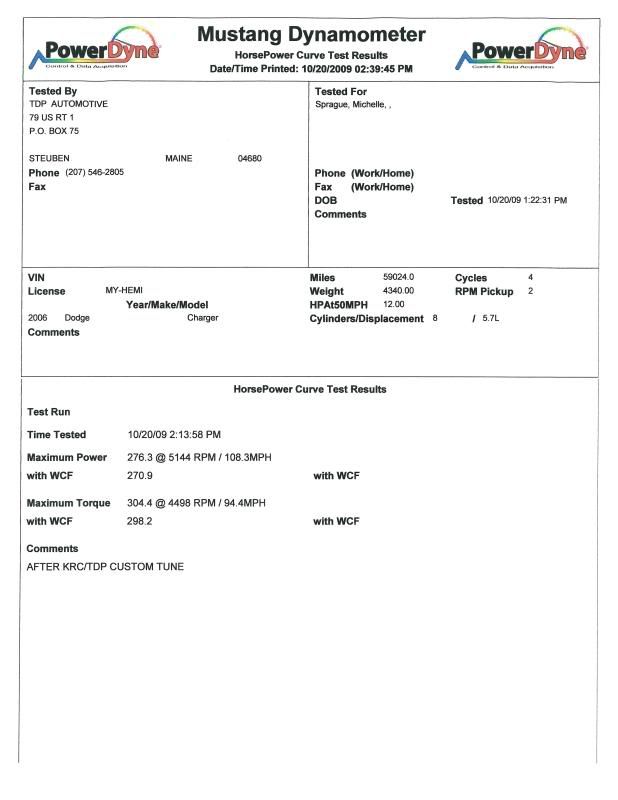

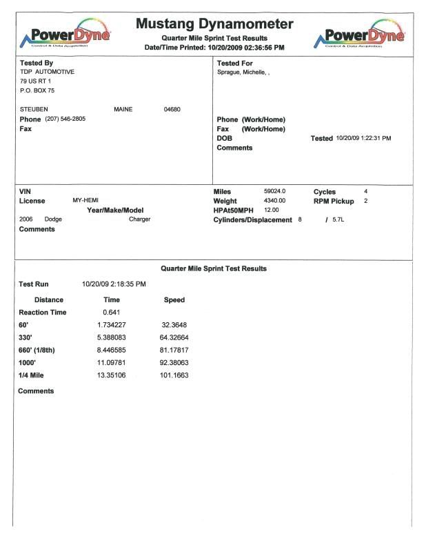

    Had a custom CMR tune/dyno tune (Mustang) done while on vacation in Maine last week! Boy was that fun!
    Went to TDP Performance in Steuben Maine last year (2008) and had some dyno runs done with everything stock except for a drop in K&N air filter. Came in around factory specs.
    Dyno Result Chart 10/08
    Quarter Mile Results 10/08
    On to this years visit with Tim...
    We have added in an Airhammer cold air intake, a Corsa catback system, and a Predator tuner this year for our major "performance" mods.
    1) We set the tune back to stock to see what the intake and exhaust system added over the stock with drop in filter from last year...We only gained about 2hp! Granted, I have 255/55-18 General Grabber UHP's this year over the stock 225/60-18 Goodyear Assurance tires, so a few horse was lost there...but we were hoping for a little, no a lot better than that!
    2) So, we put in the 91 Performance canned tune from Diablo in to see what that did (only have 91 octane available in Maine). Lo and behold.............the tune was really hurting the car over the stock tune!!! It was pulling timing all over the place and losing hp. We decide to drop in a can of NOS fuel additive to the tank and run the 91 tune some more. Still doing the same thing.
    3) So, we put in the 93 Performance canned tune. Still pulling timing all over and not doing very well.
    4) Tim then decided to give his buddy in FL a call to see what he thought. That lead to sending down my stock tune to him via email and seeing what he could do....Put in the email file to see what it would do. It was basically a Diablo 93 tune with some tweaks to it. Smoke out the back end and still pulling timing.
    Another phone call and email. Loaded in the new file which changed some things up and turned off the knock sensors. Some huge smoke out the back end and some back firing taking place...
    Another phone call and email file. Turned the knock sensors back on, reset the timing paramaters so that it would only pull about 3-4* of timing instead of 10+ and did some other tweaks. Less smoke this time, but still needed work.
    One more phone call and email. Loaded in the file and boy this was much better! Did a few pulls and the timing has been smoothed out a huge amount.
    Over all, I now have about an additional 25-30 horse and the same in torque over factory stock. I am up to right around 368 hp / 405 tq now! It rolls along much smoother with hardly a touch on the gas pedal. Haven't really had the opportunity to jump on it really hard yet, but I am loving it so far! Tim did say that there was still more power to be had without going the heads/cam route yet, but we ran out of time...
    Dyno Results After Custom Tune 10/09
    Quarter Mile Results 1st Run 10/09
    Quarter Mile Results 2nd Run 10/09
    This was one of the most fun mods so far and am looking forward to the next one in line...

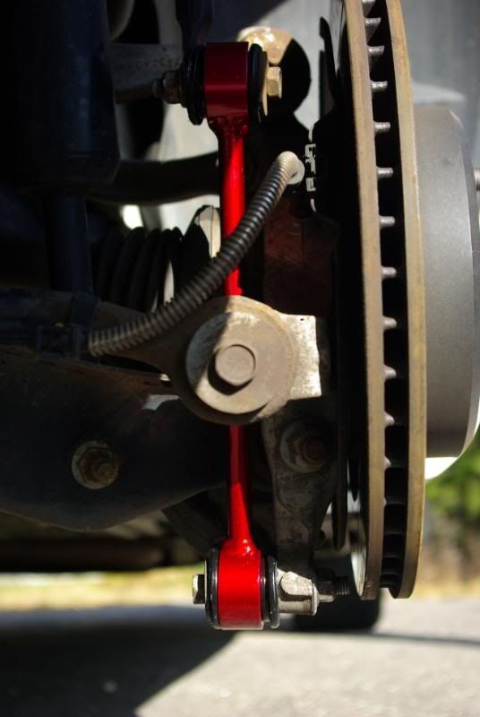

    Went in this weekend...BWoody endlinks front and rear!
    Products
    1 x BWoody Charger sway bar links (190.9004) = $209.99
    Color Candy Red (free powder coat in any color available right now)
    Got the link from here...GROUP BUY on BWOODY sway bar links
    Front
    Rear
    New front vs old front:
    New rear vs old rear:
    Passengers side front:
    Drivers side front:
    Passengers side rear:
    Drivers side rear:
    Install time was about 2 1/2 hours out in the driveway.
    BIG DIFFERENCE in handling!!!
    EDIT: Removed these (the fronts) the middle of March or so. Still making lots of noise and found that they were wearing into the metal itself and cutting up the bushing. Boy do I miss the handling!!!

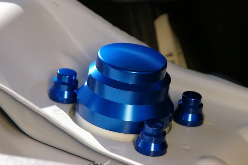

    Merry Christmas!
    Here is my Christmas present from my parents installed finally!
    Billet Tech Strut Covers "Devo" in blue anodize.

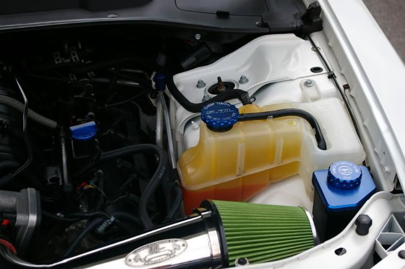

    Added on some AE Carbon Half Covers in blue to the engine bay this weekend. Thanks a bunch Wolfmann21!!!
    (pics coming soon, once I get them all spiffed up and shiny)
