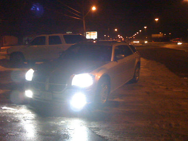

    HID MOD:

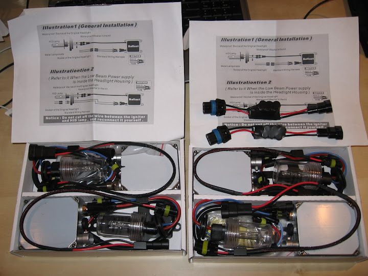

    I purchased a 9006 Low beam kit and Fog Kit both 6000K from HIDGate (Ebay Seller)
    Lows Beams:
    Installed: January 31st 2009

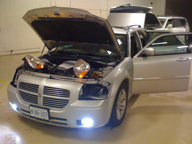

    Process:
    Removed the air box assembly
    Removed the 6 trim screws on the fascia.
    Removed the headlights
    Mounted the ballasts to the vertical support in the headlight area.
    Reversed removal process
    Tip For a stock Hemi take the 2mins to remove the air filter box that will allow you to get your hand under the headlight to prevent the bolt dropping down into the bumper. You can also start threading it in a turn or two for the reinstall. This works on both sides.
    Time involved.
    40mins.
    Level of complication
    2-5 ( hardly more complicated than swapping an air filter.)

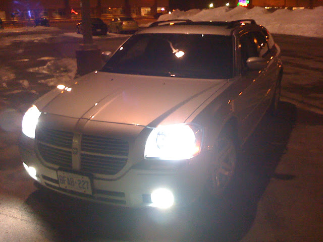

    Results:
    I'm happy they don't project as far ahead of the car as I had hoped but I'm going to play with the aiming this week. Overall for the cost I can't complain.
    Pictures: Soon to be posted.
    Fog Lights:
    Installed: Feb 6th 2009
    Process:

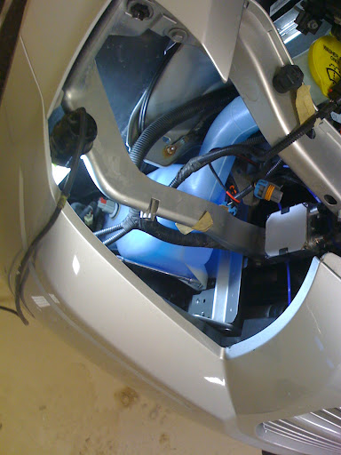

    Follow the process listed above to remove the headlights.
    Passenger side:
    I removed the bolt from the windshield washer bottle and used that to secure my bracket.
    Replace the bolt and secure the ballast bracket.
    Connect the wires.
    Install the bulb

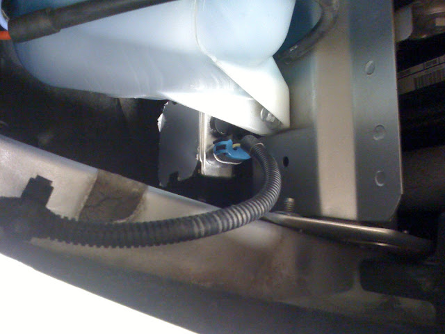

    Drivers side:
    Apply one piece of the double sided tape to the ballast.
    Secure the ballast to the underside of the support beam below the headlight
    Use two zip ties to further secure the ballast to the support.
    Connect the wires
    Install the bulb
    Turn on the lights and enjoy your work.
    Time: 10mins per side.
    Level of complication: 2-5
    Pictures:

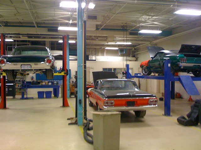

    Here is what I was surrounded by while I was playing.

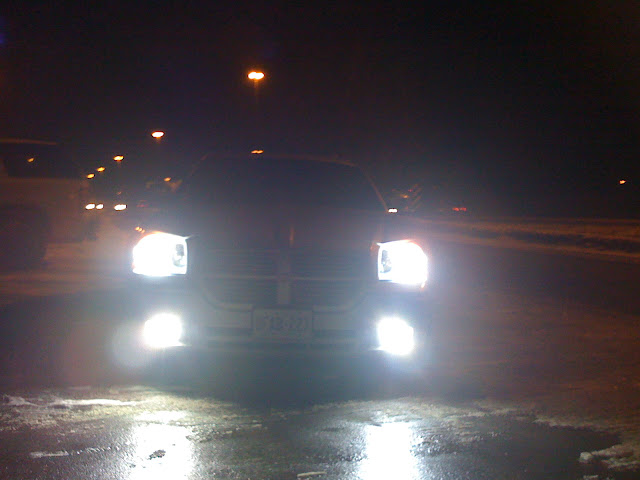

    I was worried that the fogs were going to be too bright but after driving to Buffalo and back after the install not one person flashed me so I'm not worried now. For the money I spent I really happy with the results I think the 6000K looks badass against the bright silver!!
