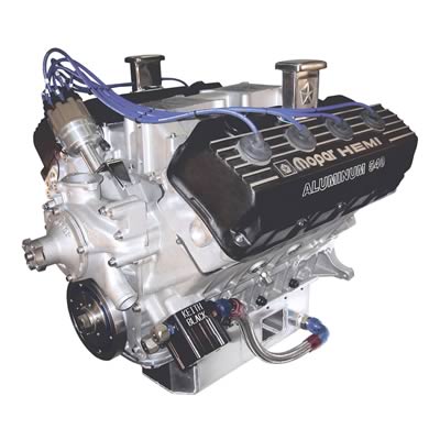

    A 540 should be enough to start you off on your performance hunt

    actually a 540 was the first thing in mind! LOL j/k anywaiiz I just want to thank everyone for their useful info, I greatly appreciate it! I'm actually reading up on a lot of stuff on engines, so I can get familiar on how everything works and how it affects performance. Once again THANK YOU!
