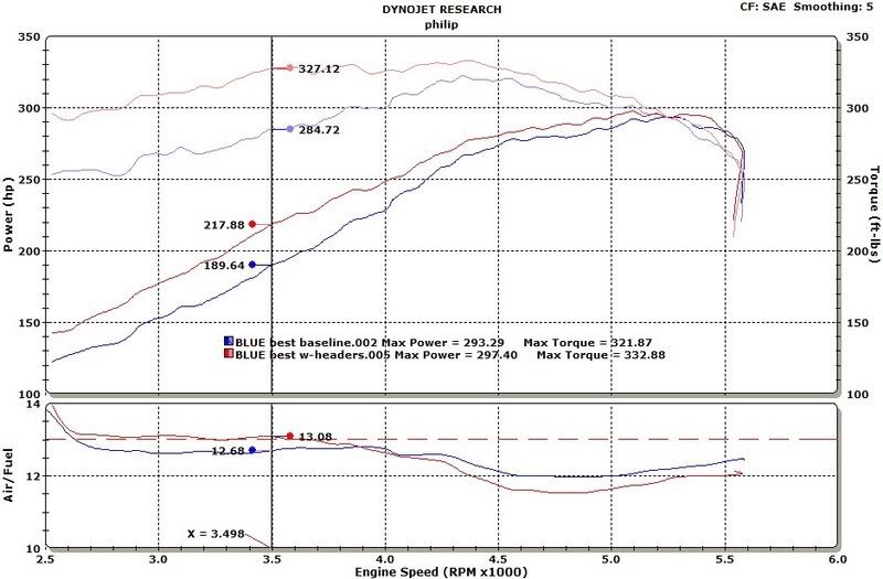

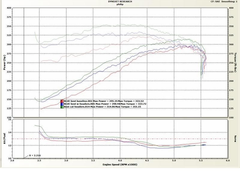

    Where are you guys getting your information regarding these top-end gains for LT's and low-end gains for shorties?? Show some dyno plots which illustrate this b/c the only good data I've seen shows just the opposite w/ the LT's. Maneval69 produced one of the best before and after dynos I've seen illustrating gains w/ just headers and gains w/ headers and catback. He did Dynatech LT headers (similar to Kooks) and I believe Zoomers catback.
    Here's the plot before and after headers (w/ stock catback):
    Note the 28rwhp gain at 3500RPM. Huge low-to-mid gains and very little or no gains at the top end.
    Here's the plot showing all 3 steps - stock, headers only, headers+catback:
    If you're going to make a claim, please back it up w/ some data. Otherwise, it's just an opinion...

    Quote Originally Posted by RTaddiction View Post
    My 0.02.
    Let's see his dyno with shorties to base your claim....after all it is a comparitive statement you're making, and all he has is a dyno sheet with a stock exhaust vs. long tubes.......not stock vs. shorties. vs long tubes.

    RTaddiction's Avatar
    RTaddiction is offline LX Newbie
    NW Ohio
    568
    I'm not making any claims of how shorties compare to LT's because I don't have the data to back that up. That's my point. My heresay on the topic is just that so I'm not going to make any claims either way.
    The data that I have seen shows that the LT's greatly improve low to mid range but have no marked gain on the top end until you add the catback.
