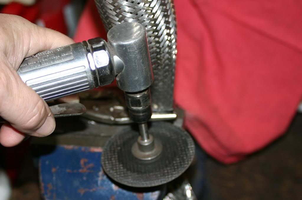

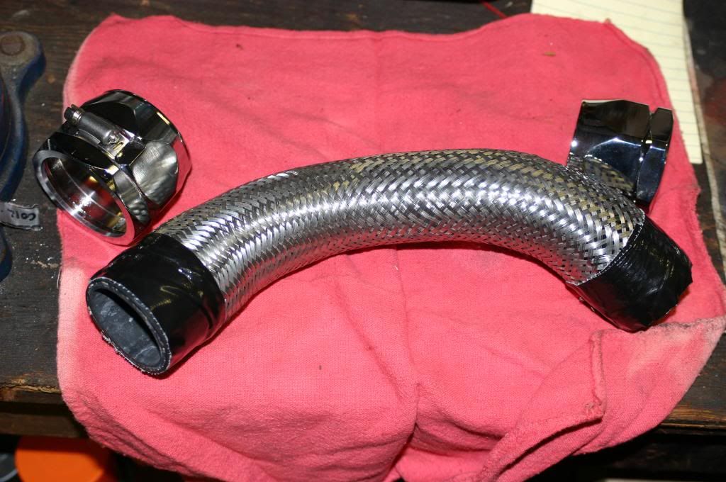

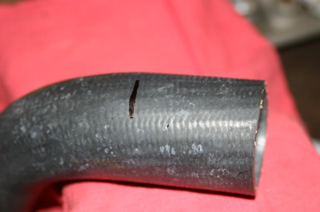

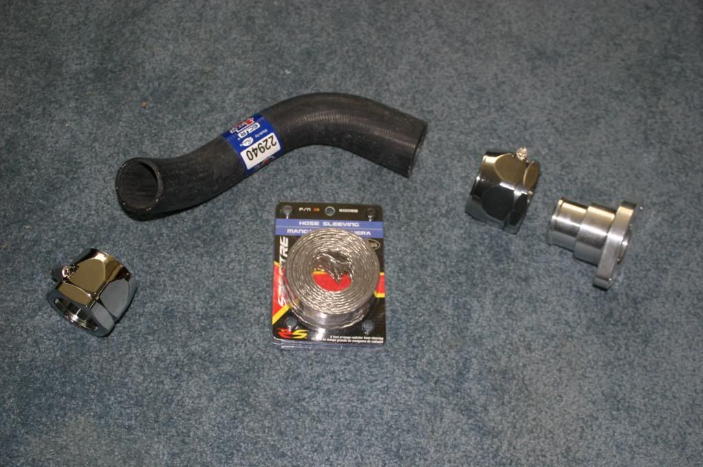

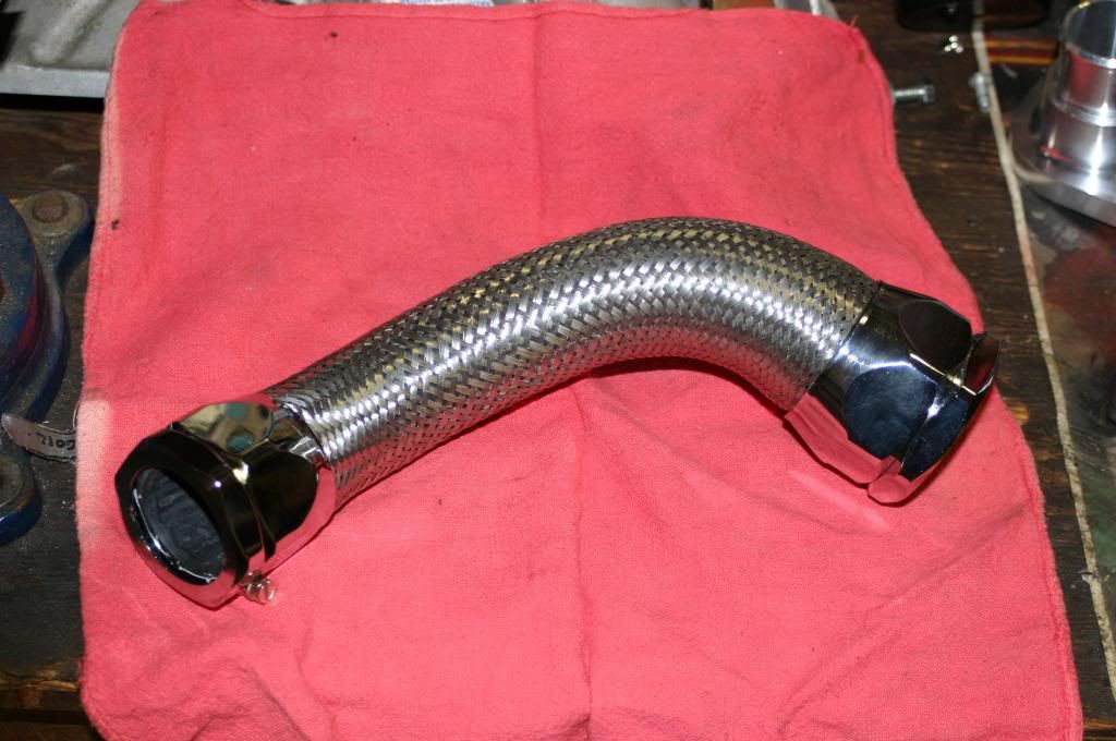

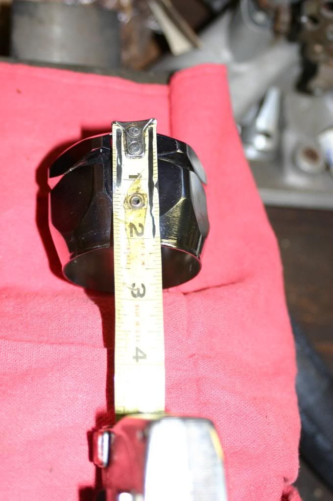

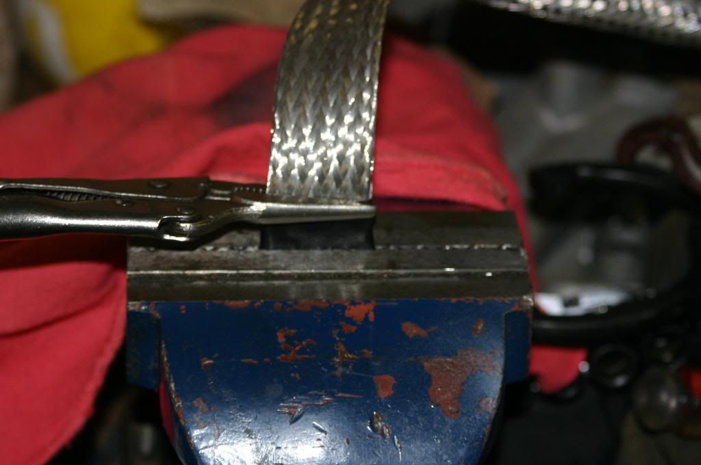

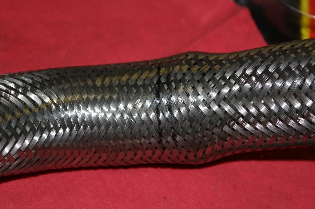

    Smile How to cover your hoses w/spectra steel braided sleeve

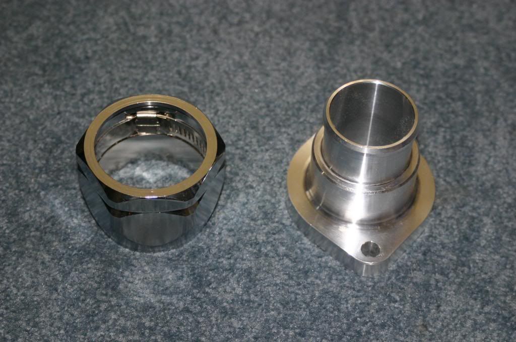

    Here are some pics of how I covered my hoses w/Spectra braided cover. Keep in mind that the upper hose has 2 different size ends so measure carefully before ordering your hose ends,and there are 2 different kinds of braided covering,one is actual stainless which needs to be cut with a cut off wheel and the other is tin plated copper which you can cut with ordinary scissors. If you use their hose ends(2 piece style) with a BT water neck,the I.D will need to be opened up using a lathe or a dremel tool
    Heres the new upper hose,ends and covering
    BT waterneck and hose end to be opened up
    Measuring the hose end
    Use that measurement to mark your hose so you know how much sleeve overlap is needed
    Slide the sleeving over the hose and mark for your cuts
    Place tape on the sleeving where cut is to be made
    Clamp the hose w/needdle nose vise grips
    and make your cut

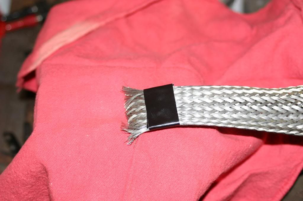

    Use black electrical tape to build up ends

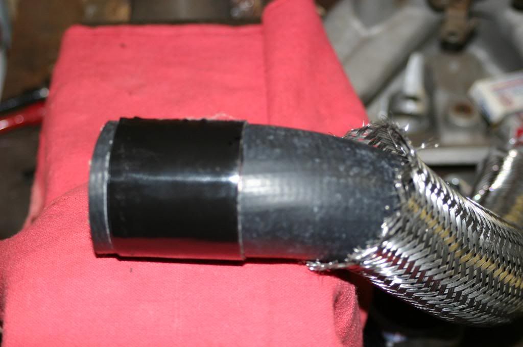

    Tape the ends of the sleeve in place,once again using black electrical tape
    Put your hose ends on and your done
    Make sure to tighten and re tighten your hose clamps over the next few days after install as the tape adhesive gets soft from the heat and your hose may slip off if not re-tightend ( don't even ask how I know),D
