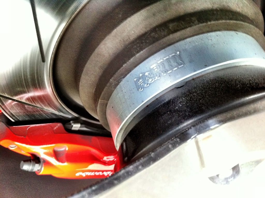

    I have H&R 30mm spacer ADAPTERS. This pic below shows the difference between spacers (left) and spacer adapters (far right).
    Spacers still use the stock studs whilst adapters have their own studs that the wheels bolt to.
    Because I went with adapters, I didn't deal with the situation that Magnitude brought up in his post above.
    Here's a pic of the aluminum/magnesium fatty patty adapter.
    My application is super aggressive and took rolling and massaging the fenders to overcome rubbing.
    If you're going with a traditional spacer, I'd get more info from other members that use them. In my situation, as long as the adapters are installed correctly, hub-centric and of good quality, they'll work just fine.
