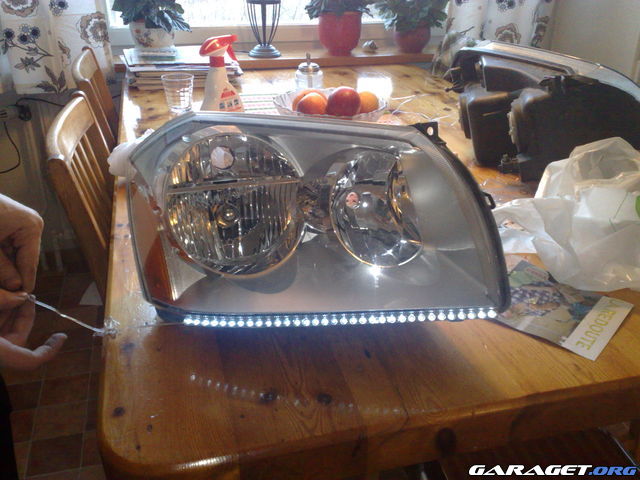

    Leds under headlights:
    Cost: Under $30
    Search for White Led Stripes on ebay: http://shop.ebay.com/?_from=R40&_trk...All-Categories
    You need two 48cm leds and then you will have to cut some leds off (just measure). They are wired in pairs of three, so you will have to cut them in groups of three. If you cut one led, the two next to it will stop working etc.
    I think i had to cut 6 or 9 leds.
    Then glue the stripes to either the headlamp, as i did, or to the car.
    I connected mine to the parking lights or whatever its called (first position on the knob). And since i have switched my turn signal bulbs to led ones, the headlight is completely dark (the led bulbs only work as turn signals, not as park lights).
