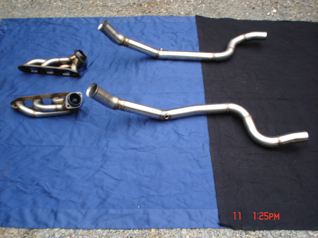

    look at the picture....
    you can see where the mid pipes connect to the header... its a 2.5" pipe (if i had to guess...)
    you can see it neck down to 2.25" right after t
    MAJOR RESTRICTION
    look at the JBA offroad pipes...
    (ok the above picture says HHP, i got it from their website, but theyre identical to the JBA's, and the "hhp" catted midpipes also look identical to the JBA's... i assume they are JBA's...
    either way...
    see how they dont neck down?
    your ebay link is very low quality, i would avoid that set

    Quote Originally Posted by dudeiwin86 View Post
    MAJOR RESTRICTION
    either way...
    I was thinking that the Ebay header had a 3" outlet, and in the midpipe necks down to 2.5".
