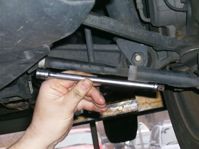

    Well, I finally made it to 30K on the clock. (30,600 to be exact) Took the 300 in for the 30K checkup. While up on the lift, the technician noticed that the passenger side inner tie rod was bent slightly. (About a month ago, I rolled over one of the ornamental rocks at the edge of the driveway) I didn't see any noticeable visible damage from what I could tell.

    (The top picture is the bad side, and the bottom is the good side-The hand in the pics belongs to the technician, the photos were shot by the service advisor)

    Are they charging you becuase you rolled over something? I had a broken one when I went for my 30k service and it was replaced under warranty. If you are not over 36k you are also still under warranty. But there is the issue that you admitted rolling over something, and there are the scrape marks on the rod.
    I agree. Unless they can prove you did it they should cover it under warranty or try getting a used rack and having a local shop install for less money.

    maybe sand the tierod a little and then use some cheap flat black paint and cover the scrape and then after it`s dry dirty it up a little and take it to another dealer. they`ll never know and probably replace it under your warranty..

    do you really need it? If its not under warranty I would wait. I mean you didnt notice any problems till they told you rite. You may be able to just get away with an aliment.

    That's possible, but I wouldn't chance it. The tie rod is meant to withstand force in a straight line, between the outer rod end where it attaches to the spindle and the rack itself. Well now that it's bent, all the forces that it used to withstand along its axis are now working to bend it even more. Push on the ends of a paper towel tube (empty). Push straight in, don't grab hold of the ends w/ your fists. Nothing happens, right? Now bend it in half and then straighten it out the best you can... push straight in on the ends again. It buckles a lot sooner... same principle! Plus, all metals are subject to fatigue, though steel isn't as bad as others. You know how when you flop the tab on a pop can back and forth about 30 times it finally just falls off in your fingers? You've already bent your tie rod once now...
    If it breaks, you're left with one wheel flapping in the breeze and essentially a total loss of control over your car. I don't know about you, but I wouldn't like to hit a pothole at 50 and have that thing let go!
