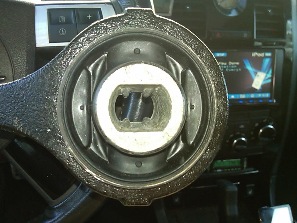

There is a new V6 and 5.7L part number for 2010, and that is what I received..
the box was marked with the 2009 replacement part number 5180607AA and 5810606AA (left and right)
BUT
the parts in the box were marked 5070123 and 5070122 (Left and Right) revision is presumed to be AA (last 2 digits)
Dealer look it up and it is a new part number for 2010 and this is why:
a completely revised bushing:
compare that to the old bushing, which is solid:
and cracks like this:
additionally you will note that the bushing has it's own part number 5180608AA and dealer showed this had a cost of $1.00 but I suspect that is because there is no actual price set for it yet.. But this means the bushing can now be ordered separately and pressed into the existing Tension Strut, I didn't want to remove the safety cap off the bearing, but I am wondering if that too will be a separate part number, seeing as Moog is now making/selling it as a separate part.
