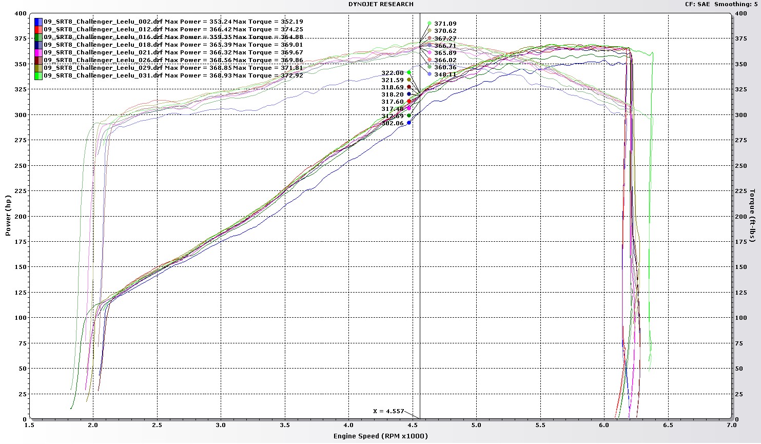

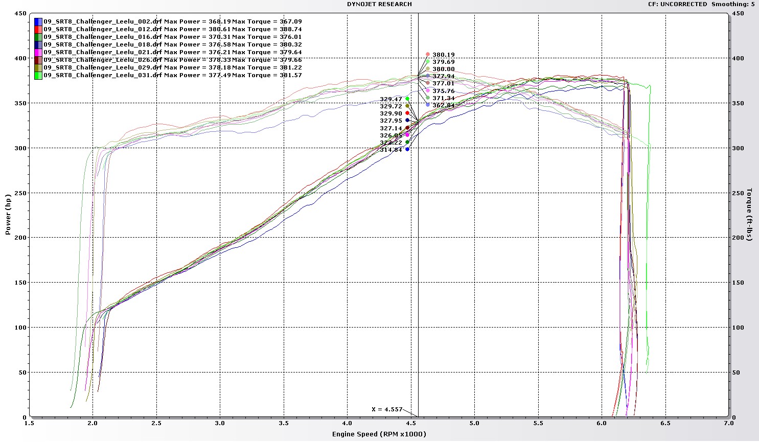

    Ok, sorry for not posting sooner, but here are the results:
    We documented temperatures for coolant, oil and air intake for each run to see if there was a correlation, which there was. It seems that having the engine closer to 180 makes more power in general and over 205 there is a definite drop off, appearing sort of like retarding the timing or fuel. Another thing we noticed was that we base-lined the car on this day and found that most of the horsepower I had gained with the exhaust work seemed to have vanished. We were back to 359 hp SAE corrected vs. 353 hp SAE corrected stock. The reason I show SAE is that comparing different days, this should be a little closer for changes vs. uncorrected. The SAE corrected 380 whp/wtq from the exhaust pulls is 366/374. So, using this, we lost 7 whp over the course of the week since the last test. Not sure if this is due to the EMS trying to "adjust" or what exactly but regardless, we're down on power. It also appears we had some really good air on the day we tested the exhaust. So, here's the rest of the results from the Intake mini MFO, trying to post the runs that didn't "dip" towards the top end, what I've been thinking is knock retard due to a noisy or lean condition in the engine, most noticable at around 203 deg or higher.
    Run 02 was the highest "bone stock" run on this car.
    Run 12 was the highest "headers and exhaust" run on this car.
    Run 16 was the smoothest "headers and exhaust" run on this car on MFO day.
    Run 18 was the smoothest "+K&N" run on this car on MFO day, showing a gain of 6 hp and 5 ft-lbs.
    Run 21 was the smoothest "+Airaid" run on this car on MFO day, showing a gain of 7 hp and 5 ft-lbs.
    Run 26 was the smoothest "+AFE Stage 2" run on this car on MFO day, showing a gain of 9 hp and 5 ft-lbs.
    Run 29 was the smoothest "+Airaid no Filter installed" run on this car on MFO day, showing a gain of 9 hp and 7 ft-lbs.
    Run 31 was the smoothest "+Airaid +Preadator 91 octane tune" run on this car on MFO day, showing a gain of 9 hp and 8 ft-lbs.
    All in all, uncorrected she is at 378 hp and 381 ft-lbs at the wheels, which is not bad, but still not sure where the gains for the exhaust went. Also the AF ratios were kind of troubling at first, but found that by putting the sensor in the collector it worked much better than at the exhaust pipe exit. Given the good AF ratios, we were not really suprised that we saw no real gain with the Predator, though were hoping for a 10 hp at least increase. As for Intake to intake, I believe the results are negligible, and the AFE's biggest gain was similar to having no filter on the Airaid, or basically, a filter that doesn't filter much besides small children and low flying birds. K&N and Airaid have the best filter technology, and the build quality of the Airaid was the best overall so I went with that for my choice after seeing and installing all 3. Hope this information helps some out there
    SAE Corrected Graph
    Uncorrected Graph
